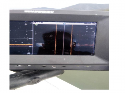

I have 898 Unit, my side and down image does not work, normal sonar ok the problem occurred after navigating in my bass boat the connector of the transducer was disconnected and reconnected with the unit turned on, sending photos, and I tried another transducer , another cables, software update and I still have theila_rendered same problem, send photos

i have on the troll motor a 997 si unit working, with no problems, change the units and the 898 have the same problems in the two sides, and the 997 works in the 2 sites

You've narrowed it down to the unit  ...
