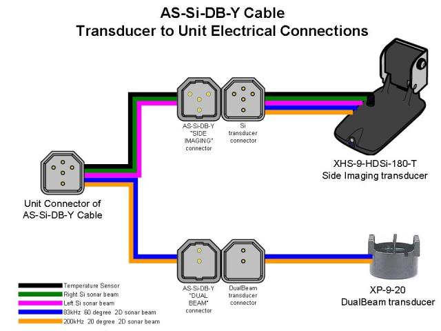

I have a  798ci SI Combo, and it's hooked up like this:
( source: http://forums.sideimagingsoft.com/index.php?action=media;sa=media;in=218 )
 I'm using the XTM 9 HDSI 180 T transducer near the transom on a custom made bracket mounted to my jacking plate.
I also have the XP 9 20 T "puck" transducer epoxied inside my hull with the temp probe mounted in the water on the transom.

The temp probe in the XP 9 20 T that you have externally mounted into the water at the transom has no operational functionality ...
There is no temp channel wire in the "Dual Beam" leg of the AS SIDB Y cable ...so the temp probe of the XP 9 20 T is a dead channel (no wire) ... You can see this in the very diagram you posted for the pinout of the AS SIDB Y cable ... the "Dual Beam" leg only has 2 pins = the 2d pin at the top and the ground/drain in the center ...
It would have sufficed to use the XP 9 20 instead of the XP 9 20 T for using the AS SIDB Y cable setup ...
The temp reading in the AS SIDB Y cable setup is always coming from the HDSI connected to the "Side Image" leg of the AS SIDB Y cable ...
