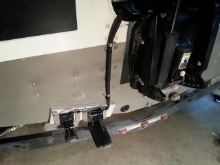

What I've heard from you'all is that there is no perfect first time installation for a SI transducer.  Apparently, the SI transducer needs to be adjusted to fit the boat conditions and it's a bit picky how it's set.  So, rather than guessing at hole placement and probable re-re-drilling, I decided to make an adjustable mount.  My objective in making this mount is to be able to move the head up & down, and rotate it to match the water line.
First, I had to deal with a water inlet screen that is mounted at the very bottom of the boat's transom.  After a bit of measuring and fiddling I decided to cut out the lower half of the inlet screen.  Actually what I did was use a die grinder cut off wheel to cut the screen on the lower half and wrap it back into itself.  I then placed a small piece of plastic over the lower half of the screen mounting, as these photos show.  It should have more than enough screen and pipe cross section to feed water to the live wells.
I used a 3 1/2" mounting board to mount the 2 transducers and used aluminum circular mounting plates to provide adjustability.  The mounting plate for the SI transducer fits into a milled recess in the plastic board.  I did this to get the transducer as close to the transom as possible, yet clear the inlet screen.  The back of the transducer is just below the line of sight with the lower half of the plastic plate on the inlet screen.  The other transducer is mounted similarly, but higher than the SI transducer.  But, the circular plate on this transducer is mounted on the face of the plastic board instead of in a recess.  In both assemblies the circular plates are held in place with aluminum compression strips screwed to the board.  Using this design I am able to not only move the transducers up & down, but also rotate them to match the water line. This is a temporary setting, I haven't put sealant on the board & screws, nor are the transducers initially set quite right.
One of the questions I have is whether I'll get the infamous rooster tail from this set up.  I'm thinking about placing a small deflection plate just in front of the SI transducer.  I may also install a transducer saver once they are available again.
Side view showing the clearance and positioning of the SI transducer.  I can adjust it up/down or rotate it to adjust for boat position when I get it in the water.
One of the questions I have is whether I'll get the infamous rooster tail.  I'm thinking about placing a small deflection plate just in front of the SI transducer.  I may also install a transducer saver once they are available again.

Very Nice!  That is nice work!
Quote
As for the roostertail, Probably so!  HB has a plug that fits in there now.  The deflector plate would work also, but the plug would be cleaner.  Call HB and see if they will send you one.

   That is the nicest install I've seen. Well thought out.
   Congratulations.

 I have to agree with the rest here ......... that is the best install I too have ever seen
very nice job, I want to know how it works out ......... I might need to do the same thing to mine,  keep us updated please

Very innovative install.
Nice work.

Thanks guys, I appreciate the feedback.  Since I've never installed this system before, this is literally making it up as I go.
Like Short Grub said, let's see how this works out.  The aluminum rotation plates seem pretty solid - more solid than the two screws that hold the mounting board to the transom.  When I drilled the mounting holes I was expecting to hit a solid transom filler, probably plywood.  But, no - seems like it's just empty space behind the aluminum sheet at those two screw locations.  So, I may add a couple more screws.  Then, when I add sealant I'll add a bead around the screw holes, all along the perimeter of the board on the back side, and seal the edge joint.  I'm going to use Boat Life LifeSeal - recommendation of a local Lund dealer.  I suspect the sealant will have more holding power than the screws - hopefully.

What is the left ducer?  Is is a high speed 2D for the same unit?
Alot of the spray comes from the openings in the mounting bracket, and not a true "rooster tail" in the sense of the word.
Water jets thru the "H" opening, and hits the top side of the tranducer and launches it upwards..
I'm guessing here, but the HDSI seems to be a bit low overall.  You will have a nice picture to the left, and  some interference off the hull to the right. Not interference, per se, but air bubbles, turbulence off the keel etc. its kind of the nature of the beast, and the higher the deadrise angle, the worse it can get, but it should perform as designed.. Your right side may be slightly darker than the left, at any speed above idling.
Very ingenious mount you have there!
Hate to see her go, but love to watch her leave.

Reddog: Thanks for the comments.  As I mentioned, placement of the transducers in the photos is temporary, just roughly setup to show the mounting.  But, I value your comments for reference when I complete the job.
Yes, the small transducer is for 2D, as suggested by HB Tech Support.  They said that it is very likely that the SI "puck" will drop its signal at high speeds - though each boat is different.
I received a rubber plug to put in the "H" hole of the small transducer.  I did not get one for the "puck".  I'm going to call HB and see if there is a plug for it.  I may make a sheet metal piece to deflect the spray if is still a problem.

Is the bunk in any danger of colliding with your 2d transducer. My Lund has 2 wide bunks on each side and I'm going to need to mount my transducer plate off to either side to avoid and issues with contacting the bunk.
Here's the scenario I was concerned about - If you ever ride up your front guide yoke (final guide wheel) on the front of your trailer  (when re-loading you boat) the boat might tilt up and the transducer might contact with the bunk.
It's hard to tell how close you are in the pictures - that would be my only comment - other than that - I'm ding the same thing with 1800 Tyee.

EZM - You are correct - the trailer bunk impact to the small transducer is a concern.  But, I think it will work OK, here's why.  First, the front bow stop keeps the boat from moving too far forward.  I have to really suck the winch up tight to get the bunks to hang aft more than 1/2 - 3/4" (the reason for the over hang is to make sure the bunks take the vertical load on the aft transom plate and not the bottom of the boat.  Otherwise the bunk will create an indent in the bottom of the boat just forward of the transom.).  With the small transducer mounted on a 3/4" plastic board, the transducer hangs back about 1 1/2" (need to recheck that dimension - but there is a good bit of clearance).  Further, when loading & unloading, the trailer drops away from the boat, so there shouldn't be any opportunity for the transducer to hit the bunk.  I've look at this quite a bit and it seems like it should work OK.
One thing I do need to recheck is whether the round mounting plate that I use in this design is sticking down below the bottom of the boat.  That plate needs to be above the bottom or the bunk could possibly hit it, and that would be a problem because the impact would be taken directly on the mounting board.
The other factors in mounting the small transducer where I did was driven by the rivet placement on the bottom of the boat (don't want to mount the transducer in line with the row of rivets) - and the fact that the small transducer must be mounted above the horizontal plane of the SI puck transducer.  So, if I didn't mount it were I have it, I would have had to extend the mounting board (or use 2), and move up (port direction) farther.

Here are a few photos of my final installation that I thought you'all might like to see.
Here's the transducer mounting arrangement:
I used a 3/8" water hose to route the transducer cables up and over the transom.  I also used a similar arrangement to cover cables that run across the front of the transom.  This is a bit of over kill, but it adds great protection to the cables.  I split the hose with a razor, placed it over the cables and tie-wrapped the hose together.
I really don't know if I have the transducers set right, but I'll give it a go and adjust as needed:
Then, even though it may not be necessary, here's how I decided to mount my GPS unit.
I made an aluminum plate for the bottom of the GPS and used velcro to mount the unit:
Then when I've got the cover on and traveling, I pull the GPS off the velcro mount and store it on the inside of the gunwale using another velcro strip:
Since I plan on not keeping the HB Control Head in the boat when stored, I want to be able to easily remove the cable bundle connector.  Unfortunately the thumb screw that comes with the unit is a real pain to use.  It is too small and hard to get a hold of.  So, I machined a small extension knob that allows for easy removal of the cable bundle.  I just slipped this new brass knob over the old one and epoxy'd it in place.

MTBob
   Once again, nice install.
   I see one area of possible concern. I notice that each transducer cable is secured with a clamp on the
   mounting board. Have you manually tripped each transducer to verify that the cable has the freedom to
   move without kinking? If you hit something, the transducers are coming up hard and fast. I originally
   had mine clamped like yours, but after watching the cable movement, I removed the clamp.
             Mike
