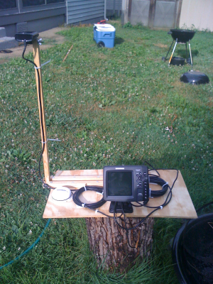

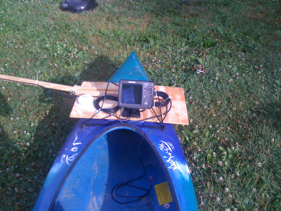

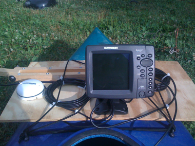

So when my wife said I could get a fish finder..apparently she didn't mean this...so I'm banned from future purchases for a month,.   (Including the kayak I wanted to mount it on...anyone got a Manta Ray 14 for cheap)?

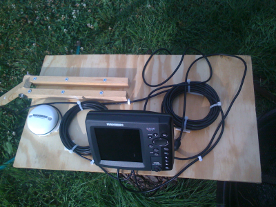

Basically I had $0 budget to build my mount, and given the way I launch my kayak, I need a way to get the transducer in and out of the water.
Looking back I definitely should have used thicker plywood.  Had I not been so excited to try it out I may have even measured the screws and noticed it would pop through.
Of course I didn't RTM on the unit either, and just went out and played on the Christiana river , so forgot to enable screen images..but I did find a car :).
Gonna go back out later, and take a screen shot/waypoint and send to the DSP dive team... no way I am getting in that dirty water.

The piece of wood used to mount the transducer seems to cause a bit more drag than expected, and likes to turn the kayak if I'm not careful. Thinking of switching to something else, but its very nice to not worry about scratching the transducer.
 This site has some interesting rigging options,  http://kayakfishinggear.com/
This was my inspiration, by itself not too bad pricewise, but needs a few extra's to fully mount.
http://kayakfishinggear.com/liberator-mini-3x6mountingplatform.aspx
