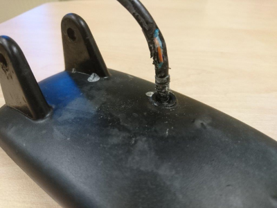

Hi
I just finish my tow fish, unfortunately have a small problem on my transducer.
My transducer cable is damage just above the transducer itself. The cable gland was also damage so I had to remove it.
I am not worried about the cable, as I sure I able to solder it together. My biggest concern is how to seal the transducer so it would not flood the first time I put it back in the water.
Any suggestions on how to approach this?
[ Specified attachment is not available ]

Hi Kenneth
All make good clean, abrade with fine sandpaper and then sealed with a sealant (Sikaflex, Bilthema ect). Here, the sealant generously apply and a cone around the cable forms.

Hi Rüger
Thanks for the reply.
Unfortunately the ground wire was damage and broken off just above the transducer. I manage to grind a hole in the transducer and solder the ground wire back on.
Now to the big question. Is it possible to measure the transducer circuit?

I don't think measuring the circiuts is needed. A damage to the cable should have no effect on the interior of the transducer. Just follow the colors of the wires and reconnect them.
