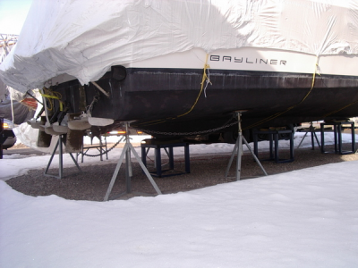

My unit is Humminbird 798cx si combo serial # 9022502-0140
Other numbers 407440-1M and N2170
My boat is a Bayliner cruise…32 foot motor yacht series.

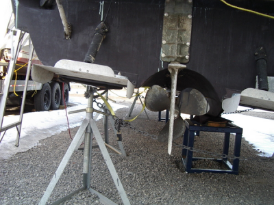

The 3288 has inboards, and drive tunnels with the props near the transom.  The rudders are outboard of the transom and the four trim tabs pretty much cover the transom side to side.
To get a clear sonar shot side to side as well as down the transducer would have to be outboard of the trim tabs.  The only way to do this is to mount a plate on the tab and install the transducer on this plate.
Of course this is not ideal.
Will being behind the props and well into the prop wash be a problem at low speeds? (I suspect it will probably be a problem at higher speeds but this is not really an issue).
I  there is a shadow area (25 degrees) on the side scan from the horizontal plan so could you shoot through the hull by mounting the transducer in a water or oil bath on the bottom of the hull between the engines and behind the keel?

Due to the engine placement, short drive shafts and general configuration it would be difficult if not impossible to use two (or even one) threw hull transducer.
THe options I have are to either stick a bracket out behind the trim tab furthest from the prop or shoot through hull just behind the keel in the centre line of the boat.
There is a possibility that  I could also shoot through hull near the bow.  I may even be able to install a through hull transducer there but I have opened the one that came with the unit.

I think I will try a side plate off the outside  port trim tab which is right out of the prop wash and where my current transducer is mounted (I will be removing it).
Worst case is that one side will act up.  I have to make the decision as once the boat is launch anything is there until lift out next winter.  In the down only mode it should be fine.  Also to the left side which is better than no side scan at all.  It will take me a year to learn how to adjust and use the unit anyway.
