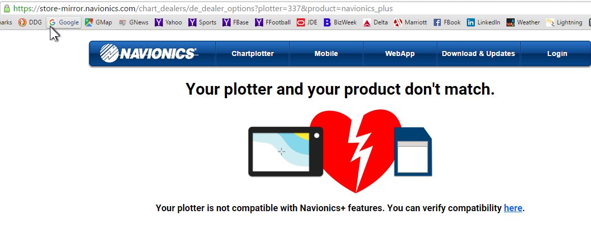

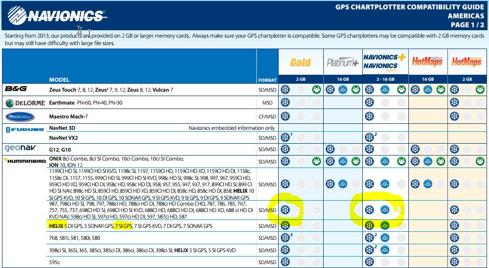

I am about to purchase the Humminbird Helix 7 SI / GPS . I will be using the unit primarily in SouthWest Florida coastal waters (not lakes). Is the Navionics+ map compatible with the Humminbird Helix 7 SI?   Humminbird customer support says YES it is but on the Navionics website, Navionics+, HotMaps Premium and even Navionics Gold show as incompatible when you select  compatibility with Helix 7 SI/GPS. So...

Shows as compatible and matches what Humminbird Cust Support said:

Humminbird site says Navionics plus is not supported. Bob
PS. The Helix 9 and 10 support it. I would call HB to be sure. Navionics put that special line in there for some reason.

Ok, thank you BobCoy.  I have an update and new question.  Update - Navionics has updated their website and the Navionics + is compatible with the Helix 7 SI.  I have purchased both and they work fine together so far (1 month).
