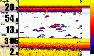

Here is a pic of what I was seeing on the sonar.  Am I mixed up, or are these fish?

« Reply #11 on: May 05, 2015, 03:49:14 AM »
Nice marks!
YES.

Re: 899 HD SI Fish ID?
« Reply #13 on: May 05, 2015, 11:19:02 AM »
It looks like your xducer is too far "tail down" ...indicated by only showing the 1st half of the arch ...
Now I doubt this has anything to do with your unit not showing the fish ID symbols ... But we gotta start somewhere ...

« Reply #14 on: May 05, 2015, 12:50:32 PM »
Thanks for the tip.  I'll tip it up a little bit and see if it makes  different with the arches and post the pic if it does.    If it does work I'll compensate the trim of the boat when I take out my fat buddies.  ;D

« Reply #15 on: May 05, 2015, 06:22:04 PM »
Hey Rickie, Looks like you may have pointed out the error in my ways.  I tilted the transponder a little bit and here is the first image I saw shortly after leaving my boat lift.  Do you see the little fishy at 13 feet?
Then I played a bit with the angle while underway.  This shot is when I changed the angle about 1/2 way through the image.  You can see the arches changed angles right when I grabbed the transducer with the boat hook.

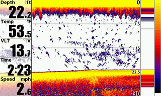

Well, downloaded and installed software version 7.590.  Took the boat for a troll around the lake and still no joy with the Fish ID+.   Think I've found the happy spot for the transducer angle, as it looks like I get full arches now (thanks again Rickie).   Played with the settings to see if I could get any progress, and also was wondering if the menu settings would be captured in the snapshot.  Did manage to catch one nice smallmouth despite the water still being on the chilly side.
Do ya' think these are fish?   If so, wonder why they don't show up on the ID?   I have the alarm set and the fish ID on.
« Reply #21 on: May 08, 2015, 10:34:41 PM »
Have you tried the Beam Frequency on 83kHz ...and then separately on the 200kHz ...??
Greg mentioned the bug was with the blended 200kHz/83kHz setting ...

« Reply #22 on: May 09, 2015, 06:45:39 AM »
Yeah, I've tried every setting possible with the frequency settings, tried changing sensitivity ranges and surface clutter.  As a lot of people say, getting the little fish icon isn't really a big deal as you can see the fish and structure pretty good.  But I am wondering if it is just my unit that doesn't work as advertised or if it is an issue with all 899s out there.  Does anybody have an 899 where the Fish ID+ works??  I'll keep playing with it while fishing as it gives me something to do between the occasional strike.

« Reply #23 on: May 17, 2015, 12:33:45 PM »
I finally think that maybe the Fish ID+ is kinda' working.  The other day I marked a bunch of fish while trolling for salmon on another lake.  Thing is that they were almost all on the bottom, and this time of year even the touge should be shallower.  But it is an improvement for sure.  Maybe the fish ID isn't as optimistic as I am about those arches on the sonar really being fish.  But at least now I can show the kids the "fish" on the screen.

« Reply #24 on: May 17, 2015, 08:52:36 PM »
I would imagine those arches are indeed fish ... Just not big enough to match the criteria set forth in the unit Fish ID algorithms ...
