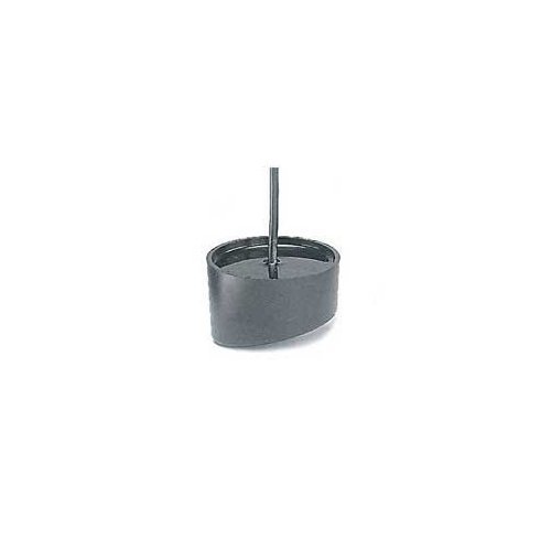

Today I hve dismounted a transducer from the boat.. And it was i expected...
The fault is on the side of the transducer where transducer cable enter transducer (plastic)...
The salt watter enters into that hole and eat all aluminium coat on the foil in which cables are twisted up to the connector which enter HB unit..
Incredible... :)
This is very very very weak point of this "great and expensive" product..
When the salt watter enters into thath hole the galvanic current is produced.. The galvanic current eat all alluminium on that foil's...
In this way the wires are without shield and normaly noise is easy reproduced on the screen..
And what now? to pay 275 EUR for new transducer with the same mistake?!?
Very poor sealing round the hole..
All foils are damaged.. There is no shield to protect it against noise...
(main foil is damaged and also other two foils are damaged)
Cable is damaged on all it's length...
Now I have few questions....
1.) What humminbird say about this? Is there any warranty of this?
2.) I will try to substitute the cable and seal the hole with some plastic (what type of material I can use to seal this?) (polyester, epoxy, ??)
3.) what type of cable is best for this purpose?
somethink like this will solve the problem..
« Last Edit: March 23, 2014, 05:51:46 PM by peterv6i »

« Reply #30 on: March 24, 2014, 04:23:05 AM »
Hi Peter
At least you now where the error has >:(
You'll probably must buy a new transducher, there will not be guarantee. I would clothe the new cable entry directly with high quality sealant.
mvh
Rüdiger
Finding is better than losing

Has anybody some suggestion how to protect cable ageinst salt water?
I will buy new transducer but I would like to secure the cable to prevent water enter that hole and damage cables and transducer..
How to seal the cable?
I think to weld some plastic tube over the actual hole and fill it with sikaflex or epoxy?
Offline Rickard
  • Location: Mariefred, Sweden
  • Posts: 513
Re: Interferences / transducer problem (snow on screen).. 998c
« Reply #33 on: March 25, 2014, 07:14:46 AM »
Hi, I have used a urethane based compound called "Liquisole" that is ment for repair of soles on shoes. It sticks extremely well to the transducer housing (ABS). It must cure for about two days, though. It's a liquid, to begin with, so you have to arrange with a mould to keep it in place. The result is something that behaves like a rubber connection. Sikaflex may be good too, but I have not tested it. Epoxi and various plastic glues do not work at all.

Here is another transducer from my friend from croatia (cca 600 km away from me)....
The problem is the same..
You can see wires which were not in epoxy (main wire was not in epoxy) and also corrupted foil as mine (galvanic current)..
https://www.dropbox.com/s/fs3vl9v56dknc9v/2014-03-27%2009.51.43.jpg
« Last Edit: March 27, 2014, 05:39:14 AM by peterv6i »

I have ordered new transducer from USA but... I have also modified the old one...
wires.. I say that temperature was not working... I cut off the red wire and put a 3.3kOhm restistor between red wire and gnd..
Now the unit shows me allways 127°F :)
Over the cable connector i pull a piece of pvc tube... with some elastic I fixed the tube to the transducer housing.
I used epoxy to fix the tube to the transducer..
after that filled up the tube with epoxy resine..
The look is not professional but it work's and now the watter will not enter inside transducer (hope) ;)
« Last Edit: April 02, 2014, 04:03:54 AM by peterv6i »

On my old transducer there works only side scan.. Classic 2d wan't work well.. seems there is some other malfunction inside transducer..
Here I have a new transducer but I make the same "isolation" as on my old one.. I have used epoxy glue with glass fiber.. on the 3/4 of the plastic pipe I put some sealant (sikaflex).. Epoxy is waterproof and it has a resistence of 300 kg/cm2..
With new transducer there are no interferences from the engine!
Also the depth is set to "auto depth"...
There are no "gaps"..
Now all works fine..
