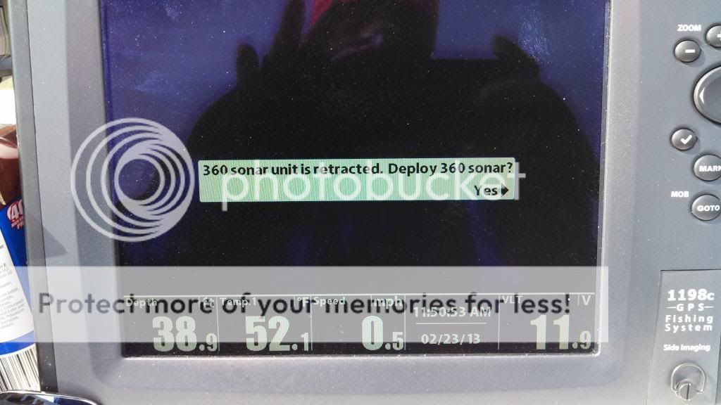

Well I took it out today and the very first thing it says is not deployed to setting please retract  and redeploy , now I played with this thing in my shop for 2weeks and never seen this. I did this all day long sometimes it was ok and most of the time I had to just go back to the unit and deploy it. I got back home and messed with it until I was feed up. Wish I hadn't ever bought it I ran it up and down 20 times with the buttons on unit no problems. Went back to 1198 and its would deploy 1 time out of 10. To my setting. My battery voltage according to 1198 and volt meter was 12.8 volts. There is no restrictions I can run it with the buttons on unit no problems, anyone want to buy a 360 unit?

Don't worry you're not the only one.  Been out with mine two times and this is what happened:
Retracting and deploying message like yours.  Only happens on the water.

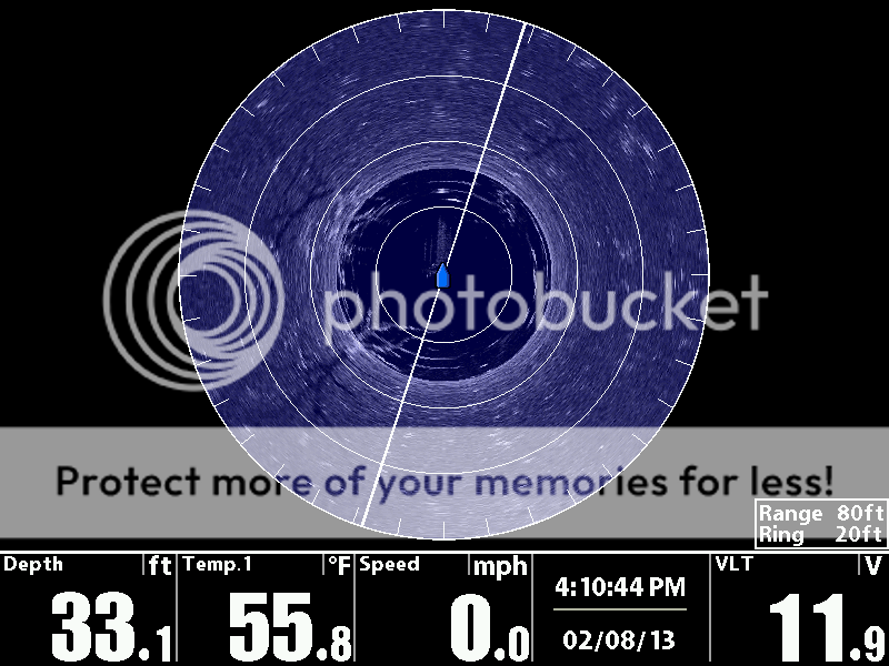

After retracting 360 and trying to switch to regular SI, unit would kick out of that and go into Bird's Eye view.  I would hit the view button to put it back on SI, kick out again and again.
Now DI has white dots and lines like interference yet the SI looks fine.  Thought the DI came from the SI signal.
Seems like there is some interference in front of the boat icon, might be the hull.  Thought it was the trolling motor so pulled it up but still there.  Only problem is the 360 is already in the water while the boat is sitting and while on plane I can see it spraying some.
Sent email to Humminbird with pics and notes.

Hi Diel, I think the DI issue is related to the 6.6 update. I get it when Sharpness is set to Low.

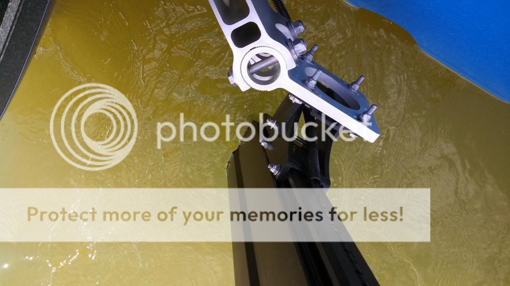

Mine did a couple of new things today on the water:
1.  Didn't give me the bad deployment message but when I looked at the 360 it had only gone down about 1 foot.
2.  Retracted it all the way, looked at it and it was ok, get going and the alarm goes off telling me it's deployed even though I can see it's not.
3.  Gave me the same message about 360 source lost.
4.  Sounded super anemic when deploying, almost like it was about to jam up.

I must be cursed or something.  Yesterday mine worked with no problems, today after the 2nd hour it would not retract.  Once again I cannot trust the deploy/retract messages.  I took pics of the 1198 telling me it was retracted, but lucky for me (as I don't trust it anymore) I checked it and it was all the way down.  It would not come up no matter what I did.  I tried rebooting the 1198, removed the 360 power cable and counted to 10, then tried again.  I cut the power to the entire boat, then started all over again.  Finally I got my boat hook and pulled the pod up.  Put the cap on it and turned it off.  About 3 hrs later I tried again, it deployed just fine, but again would not retract.  Almost sounded like it was binding up again.  Pulled it up manually again, and turned the piece of crap off.
Got the boat out of the water later, got it to my workshop and decided to try it again.  This time everything worked fine but the deploy depth had gone from 100 to 8.  Huh?
On this pic you should be able to see the top of the pod, you can't because it's still deployed.  This pic was taken right after the above one.
