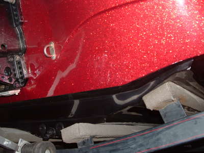

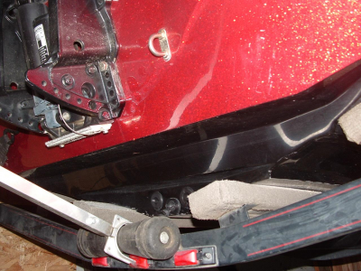

I have a Nitro 640 with NO jack plate and the hull is stepped.  I understand that if I mount the transducer on the transom as the instructions suggest, the motor will block the view on the port side.  The other problem with this location is the position of the lift strikes.  In order to maintain the 15 inches that they suggest, the transducer will be in the wake of the lift strike or in danger of hitting the bunk when loading and unloading the boat.
I have reviewed other posts and many suggest mounting under the jack plate.  Since my boat does not have one, this eliminates this possiblity.  Other posts suggest that the transducer be placed on the step next to the drain.   I  also like this idea, as the step on my boat is level and it makes sense that the transducer would get a good view from that location.  I also think the transducer would be well protected from debris at this location.  I am concerned about the turbulance that the main hull will create, however.  Some of the posts suggest that this is a real problem but only at high speeds and suggest a second transducer installation to allow me to use the finder at high speeds.  This makes some sense to me as well I guess.
I do have some questions though that I have not seen addressed in any of these posts.  Humminbird has two flavors of SI transducers.  The one that comes standard with the unit mounts to the transom or with an adapter can be mounted to the trolling motor.  The other one is a thru hull version.  It seems to me that the thru hull version would work best mounted in the step location.  I have not seen anyone talk about this being a good solution here, however.  I have also noted that the many posts covering this subject talk about issues with the transom mount version being set to the correct angle.  I don't think the angle is adjustable on the thru hull version.  That may be why no one talks about using this transducer at this location.  So what is a guy to do?
If two transducers are the answer for my boat, do I need 2 SI transducers, or can the one that I use when running on plane be one without SI?  If I need 2 transducers and both should be SI transom mount type, where do I place the one that I intend to use when I am running on plane?   I think I have ruled out the transom idea earlier.  A thru hull mount might work for this application, but as far as I know it is only available in a SI version.  If SI does not work at high speeds, then what is the point?
I'll bet you have never met anyone who is so confused.  I just want an installation plan that has a pretty good chance at success.  I don't want to be drilling a bunch of holes in my hull trying tro make this thing work.  I would greatly appreciate any help anyone can offer.  I am really anxious to get this thing installed so I can get out there and give it a try.
I have attached a couple of photos that hopefully will help.ila_renderedila_rendered

Thanks, Robert.  That clears up quite a bit for me.  I will abondon the thru hull idea.  I think that I will look at mounting the transducer in the step area just to the right of the drain and the intakes for the recirc. pump for the live wells.  I guess there will be some exposure to debris but I am hoping the step itself will offer some protecdtion.
I am not sure I understand the proper place to attach the transducer, however.  Should I mount it to the verticle section of the step or to the bottom of the hull back a short distance from the step?  Should the transducer hang below the actual level of the bottom of the boat or can I tuck it up a bit to protect it from debris sliding down the hull?   My hull actuall has 2 steps.  I have attached a picture with 4 ila_renderedsquares noting what I think might be good spots to place the transducer.  Any recommendations?

secretweapons,
I would look at mounting the 987’s transducer at the location shown by the second square from the top and offset to the side so that it is not right in front of the motor.  This will give it a little protection and you should not have to trim your motor up a lot so that the left Si beam does not get blocked.
For the inside-the-hull transducer you could go with the XP-9-20 200/83kHz DualBeam transducer but your 987 will not be able to use the 83kHz part of this transducer.  Instead look at getting he XP-9-DB-74-T 200/50kHz Dual Beam transducer as it has both the 200kHz and 50kHz frequency capabilities that your 987 has.  Which ever transducer you end up getting; connect it and the 987’s transducer to the unit with the AS-Si-DB-Y transducer splitter cable.
