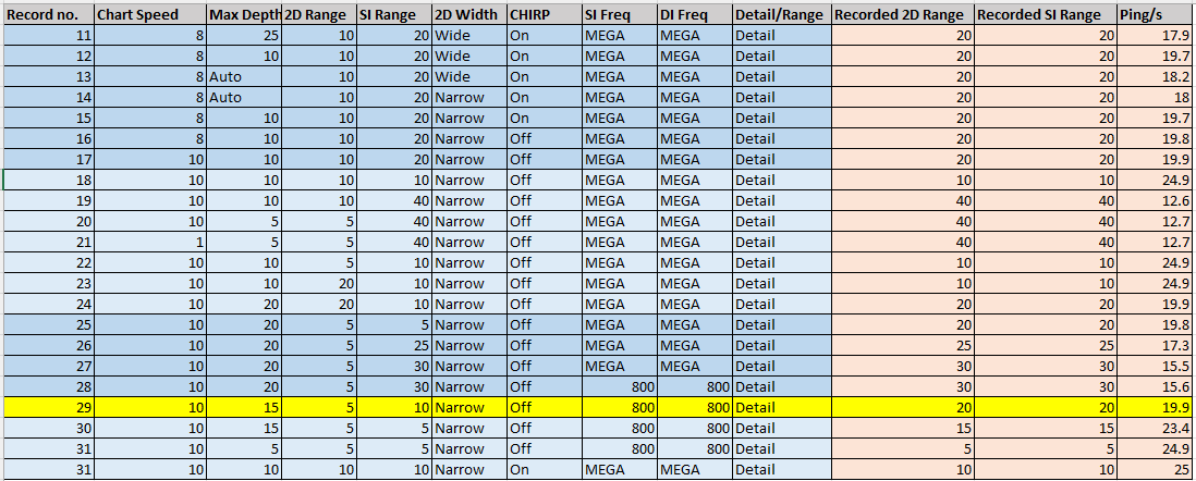

I spent the morning experimenting with the transducer in a 30 litre bucket of water. Here are some results:
I didn't experiment with every possible setting (pretty sure "detail" is always going to be better than "range" for DI mode).
Observations:
  • It is at least possible on this unit to produce recordings with ping rate above 20/s, which is a relief.
  • The ping rate appears to be driven entirely by the maximum sonar range that is set within the unit. This in itself isn't surprising, but it is worth noting that it *appears* as if the unit takes the maximum of SI, 2D *or* "Max Depth". So if you are recording with 10m range in 2D and SI but a 20m max depth, you can expect recordings to have a 20m range and the ping rate to be correspondingly lower.
  • The recorded sonar range is also driven entirely by the highest range specified. e.g. if you have a 10m range on your 2D but are scanning out to 40m on SI, then the 2D recorded range will be 40m regardless of what is shown on screen. Note: if you want to record some high-res DI, then ensure your SI is set to the equivalent low range to maximise the ping rate.
  • There is an anomolous result, highlighted in yellow. I can't be sure if I just messed up the settings for this file as there is no way to go back and check. I think that is the most likely explanation.
  • To obtain the best resolution for sidescan imagery, you really need to keep the range to 20m or less. This is a little disappointing. 30m gives a 15 p/s rate which is OK but not great.
  • 2D, SI, DI frequency and CHIRP on/off makes no difference.
  • Chart speed makes no difference, as expected.
  • These results don't immediately explain my low (10 p/s) ping rate yesterday when I was never in more than 10m of water. My best guess is that, since I had "Max Depth" on Auto, the unit decided early on to use a value of 60m interally and stuck with it for the duration of the session (all of my channels had a recorded depth of 60m yesterday).
I hope to trial this on the water soon. I have seen files from the G3 (unknown software version) with ping rates over 20/s for SI ranges of 25m. I would like to be able to achieve that. I'm guessing theoretical maximum is something in the range of 25 p/s for 25m range, given 50m round trip per ping and 1300m/s sound speed in water, so in fairness we are not too far off - and these pings must be operating in parallel already?
I still have the transducer bucket set up so if there are any options you think I should try then please let me know.

the table of matt shows that the frequency depends of the range something like
range (m) ; freq (Hz)
5 ; 25
10 ; 25
20 ; 20
40 ; 10
the reason is that if the furtherest echoe come back after the next ping, there is a problem
more : the samples are the echoes periodically recorded, so the resolution is 2 x 39,96 x 100 / 4206 = 1,9 cm (4206 is for one side only)
And as 2 x 39,96 m is travelled by the sound at 1500 m/s,  in 53 ms the sampling period should be 0,053 / 4206 = 12,6 micro second and the sampling frequency 79 kHz

I actually updated my last post just before you posted yours to highlight the fact that we are probably not *that* far away from the maximum theoretical ping rate, which would be something like 26/s at a 25m range (50m round trip), so results are probably OK.
What is interesting to me is that the max depth really does seem to have a powerful effect here, so it is probably always going to be best to make sure this is as low as your desired sidescan range (or lower). Having SI range higher than max depth is not a problem, the higher range is used.
I have since tried a few other tests, including recording with no SI on screen and background SI pinging set to off. This does indeed produce only DI/2D sonar log files, but even at 10m 2D depth range the ping rate is 25/s, so I think 25 per second may be the global maximum.
I am using my own ReefMaster product to look at the ping rate - this is a value shown for any displayed sonar log files. This is just a crude total pings/total time calculation and I think your table is about right, but with 12.5/s for 40m range. 30m gives 15 p/s and 25m 17.5/s. I think 25m may be the sweet spot for me in terms of coverage/quality, but of course that will depend on the situation. For fishing/on the water use, I don't think a lower ping rate matters too much - the increase in resolution that comes with a higher ping rate really only becomes visible on a large screen. I've also seen some excellent sidescan recorded as low as 5 pings/sec, but of course we always want the best that we can achieve!
Edit to add: your sonar file stats show a ping rate of almost exactly 10 (pings / total seconds), which tallies well with the results I have seen for 40m range. In fact, you can go to 60m and still achieve 10/s.
