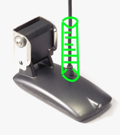

I have replaced two transducers in less than 8 years... The problem is that humidity and water enter (where gromet is) into the transducer and the galvanic current will "eat" the aluminium shield and you will get "snow" on the screen.. What I have done is that I have put a "plastic" tube over the cable and fixed and filled it with epoxy resin (tube cca 10cm in length). In this way, there is less possibility for the water to enter the transducer.  If you compare Humminbird transducer with Lowrance or Garmin you will notice the difference...
The green object represents the plastic tube.. I have fixed it with epoxy and filled it with epoxy.. You can also try to weld the plastic tube and then fill it with epoxy..

the rubber grommet is not ok because there are almost two things:
1.) after a while the grommet will become "hard" and it will not seal..
2.) when you navigate with the boat at higher speed, a certain amount of force is working on a cable and grommet.
When humidity and water enter into the transducer the first thing which will go is the aluminium shield/foil which covers certain cables. Then you will notice interferences on the screen (white spots like it is snowing on the screen).  And I have tried to fix both transducers but no way to solve it..
