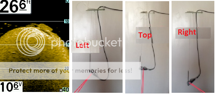

I use this handmade accessory, just pull line up and down, and know exactly what is the structure under the ice, where my hooks are and is there fish or not 80 feet around:

Vik33,
As I have said before, your principle is very clever! I'm trying to give it a name, The Vertical 180 System or SpotImaging or Down-At-The-Spot System. Whatever the best name might be, the system principle should definitly be a candidate for a new level of ice-fishing gear.

vik, do u sweep up/down or in a circular motion  with this set up
im interested in utilizing side scan or 360 for ice fishing as well
are u utilizing the si image or down imaging to get your info...
it looks like  the ducer is angled sideways in some pics on your photobucket images ??
i tried rotating si ducer on pole ....didnt seem to get much out of itany suggestions??

Dave that looks to be a Di shot swept front to back or viceversa.  Explains the hump in the image, at least this is the way I'm reading it.  The angle would give a deeper reading at the rear...center would give true depth...and front angle would read deep again.  I'm sure when he checks back in he'll fill us in some more.
I'm surprised that turning the SI ducer didn't give a good shot as long as it was steady.  The guys in the club use SI on the bow and will turn their trolling motor to see what is around them.  They use it alot when spider rigging to find the school of crappie and staying on them.

About a year ago Viktor's method was discussed here: http://forums.sideimagingsoft.com/index.php?topic=3403.msg31133#msg31133
Maybe the thread gives some clues to how it works.
