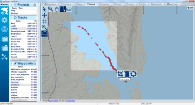

1. Edit the tracks if necessary - here we just cropped the track to keep the section that comes out of a creek mouth which can be a bit treacherous at low tide.

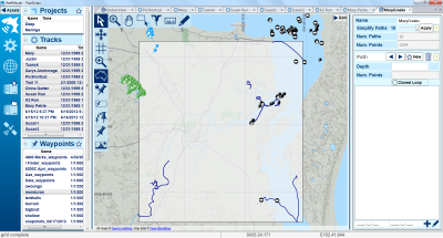

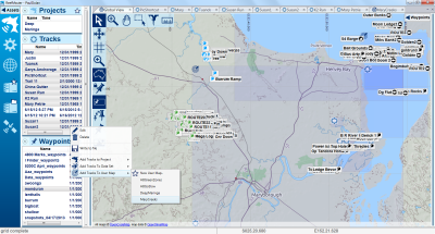

2. Add the track(s) you want to a User Map

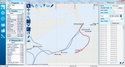

3. Edit the paths further if required - you can draw extensions, or drag nodes around, delete nodes etc. Simplify paths to reduce the track-point count if required. ReefMaster uses the Douglas-Peucker path simplification algorithm.

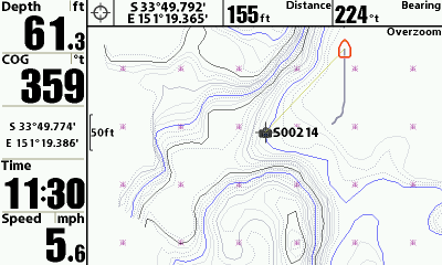

4. Once your map is done, you can export it as a single Humminbird track. Just right-click and "Write to File".
