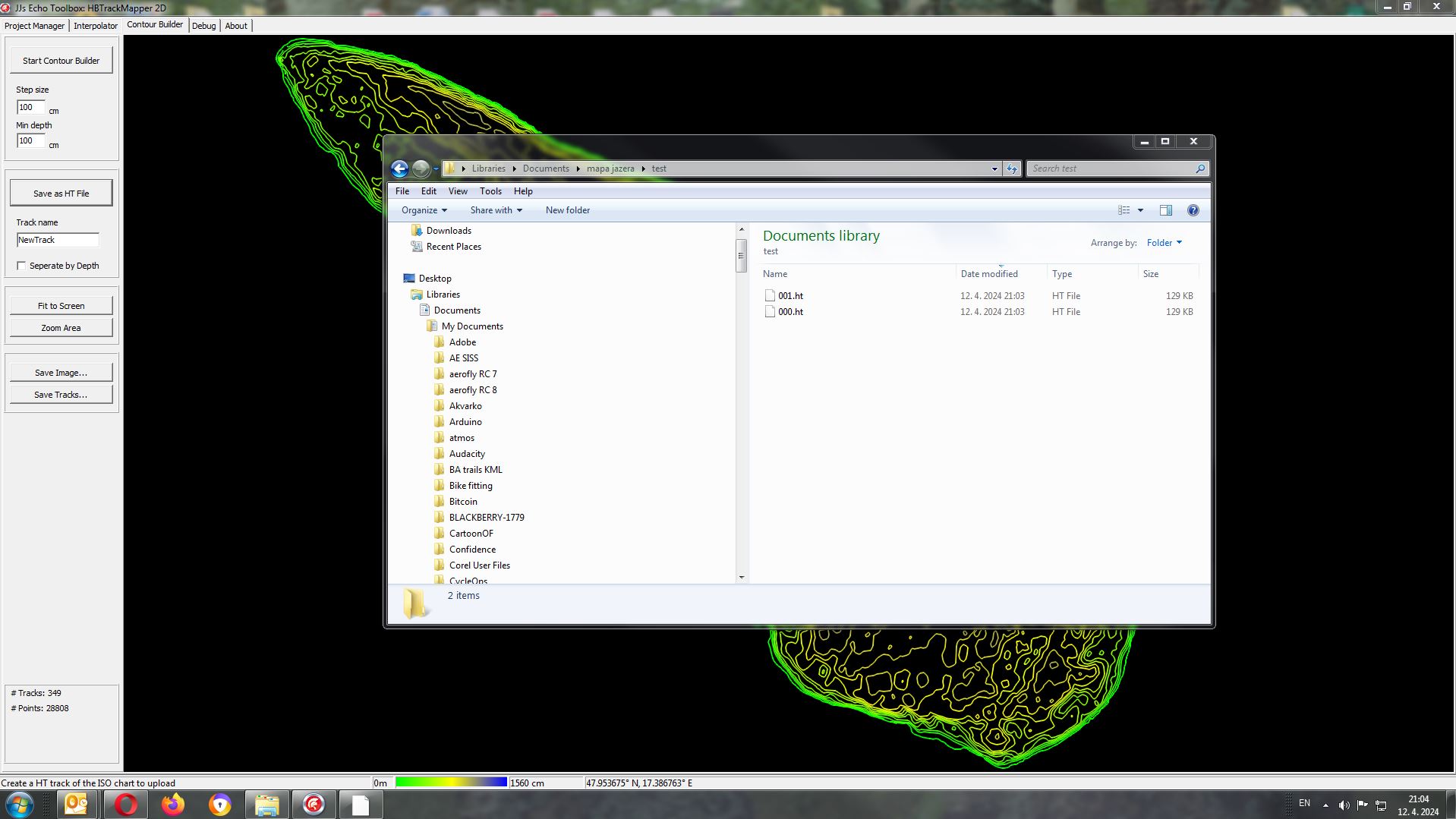

« Reply #16 on: April 10, 2024, 05:46:21 PM »
nope, no ht files written
CreateHT: splitting dataset
CreateHT: #Points (total): 2988
Save Track: ISO 700 cm
Save Track: ISO 800 cm
Save Track: ISO 900 cm
Save Track: ISO 1000 cm
Save Track: ISO 1100 cm
Save Track: ISO 1200 cm
Save Track: ISO 1300 cm

Re: Custom Charts and Lake mapping FREEWARE
« Reply #17 on: April 12, 2024, 03:08:56 PM »
Maybe it is because of Windows. I'm luckily still on win 7.
4 CPUs found
LoadGPXFile: Trying to open C:\Users\Kenai\Documents\mapa jazera\mapovanie jazera project V3.gpx

CreateHT: iterate ===== 000 ======
CreateHT: n_wpt_total is 19999
CreateHT: n of IsoDataWrite 19390
WriteHTFileC:\Users\Kenai\Documents\mapa jazera\test\000.ht
HTCOnvert: number of points to write: 19999
CreateHT: iterate ===== 001 ======
CreateHT: n_wpt_total is 8813
CreateHT: n of IsoDataWrite 8291
WriteHTFileC:\Users\Kenai\Documents\mapa jazera\test\001.ht
HTCOnvert: number of points to write: 8813
Offline Kenai
  • Joined: Aug 2015
  • Location: Slovakia
  • Posts: 49
    • Confidence
  • Unit(s): 598, Helix MSI+ 9 G4N, Helix 7 CHIRP G3N
  • Software: v7.300, v2.930
« Reply #18 on: April 12, 2024, 03:14:13 PM »
I can try to make those HT files for you, if you want.
