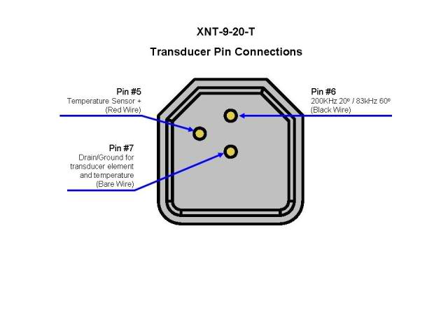

My understanding of the XP-9-20 is that the center (#7) is the drain/ground and top (#6) is the 200/83 black wire.
So not sure if I should take the two 2D wires from the 14-pin and connect to the 2 pins on the 9-pin, or combine the 2D pins and also connect the drain/gound pins.
Should I connect from the 9 pin to the 14 pin: #6 to #3 (black to black) and #7 to #7?
Or, should I connect from the 9 pin to the 14 pin: #6 to #3&7 (2D wires) and #7 to #10 (ground/drain)?
To your other question, HB did not send me a cable at all - They sent me a thru-hull mega transducer.
Here is where I got the pinout for the installed ducer connector (though mine is not the -T version)
http://forums.sideimagingsoft.com/index.php?action=media;sa=media;in=225;preview

I use pin to pin connections when connecting the LSS-2 to HB units. I get male and female pins with about correct dimensions from some old computer cable connectors. It can be difficult to arrange with shield around the wires, but that doesn't seem to have caused any effect on the image. I would not split the ground wire from #7 to one of the 2D pins and the drain pin. Just use #3 and #7 in the unit connector because then it shouldn't matter how you assign the pins in the transducer connector.
