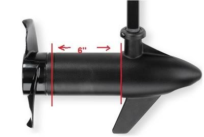

If I want to mount an XTM 9 SI 180 T on my TM
the manual for it says to mount it forward of the motor shaft.
Will it still work if you can't mount it forward of the motor shaft?

Uhhh…, you had better do some measuring than.  The XTM-9-HDSi-180-T is the same as the transom mount version HDSi transducer except that it comes with a trolling motor adapter in place of transom mounting hardware (many fishermen prefer using the Transducer Shield & Saver adapter as it helps protect the transducer).  It is the same length as the transom mounted HDSi transducer (6 inches long).

I measured the space on my TM and JUST make it
I'm guessing an XTM 9 SI 180 T would be slightly shorter?

Yes the XTM-9-Si-180-T is shorter (almost 4 inches).
