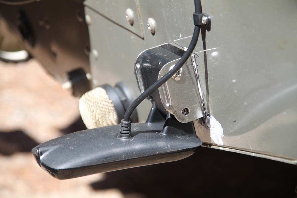

Thanks for the responses.  Here is a picture of my installation.  I think it would be hard to install this unit backwards so the problem must be in the transducer itself or possibly the unit.  If you agree that my transducer installation is normal then I might try asking the store where I purchased the unit if they could loan me a demo model to check.  ila_rendered
Re: 798ci SI Combo - Side Imaging Wrong Side Issue
« Reply #7 on: March 01, 2011, 07:48:40 PM »
Indeed it would be hard to install backwards but with a little effort it can be done.
 However your picture (a picture is worth a thousand words) confirms that the installation is correct.
I would try swapping with a working unit (the head) and see what that does...the storte may be of help with this or know a friend who may let you swap for testing purposes.  That might be the easiest weay to determine which part is at fault.
Stranger things have happened and while HB has a good quality check on the transducer assembly at the plant, I suppose something could have been missed.
Same goes for the head wiring...
Let us know results if you swap..

It also looks like the transducer is mounted right in front of a vein on the bottom of the boat witch will create turbulant water and reduce higher speed readings.  I know it has nothing to do with the current problem but it is something I noticed in your picture since you paid to have it installed they should have did better.
