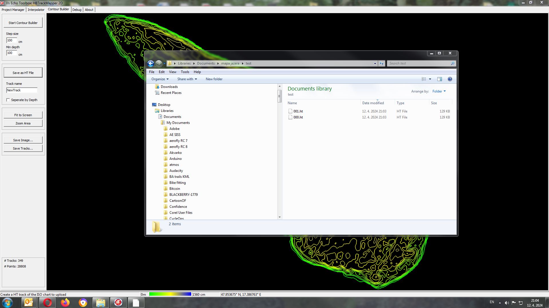

In case, someone is still interested in this project. I'm still using HBTrackMapper_V20a. I have 598 unit. Currently, I'm planing to upgrade to Helix, and I'm also interested if someone can confirm this is still working on new units.

And here is the last version of HB Track Mapper V2 http://www.lnx-ware.de/echotoolbox/HBTrackMapper_V20a.exe It seems all bugs are fixed and it works flawlessly.

nope, no ht files written
CreateHT: splitting dataset
CreateHT: #Points (total): 2988
Save Track: ISO 700 cm
Save Track: ISO 800 cm

Re: Custom Charts and Lake mapping FREEWARE
« Reply #17 on: April 12, 2024, 03:08:56 PM »
Maybe it is because of Windows. I'm luckily still on win 7.

CreateHT: iterate ===== 000 ======
CreateHT: n_wpt_total is 19999
CreateHT: n of IsoDataWrite 19390
WriteHTFileC:\Users\Kenai\Documents\mapa jazera\test\000.ht
HTCOnvert: number of points to write: 19999
CreateHT: iterate ===== 001 ======
CreateHT: n_wpt_total is 8813
CreateHT: n of IsoDataWrite 8291
WriteHTFileC:\Users\Kenai\Documents\mapa jazera\test\001.ht
HTCOnvert: number of points to write: 8813
Offline Kenai
  • Joined: Aug 2015
  • Location: Slovakia
  • Posts: 49
    • Confidence
  • Unit(s): 598, Helix MSI+ 9 G4N, Helix 7 CHIRP G3N
  • Software: v7.300, v2.930
« Reply #18 on: April 12, 2024, 03:14:13 PM »
I can try to make those HT files for you, if you want.
