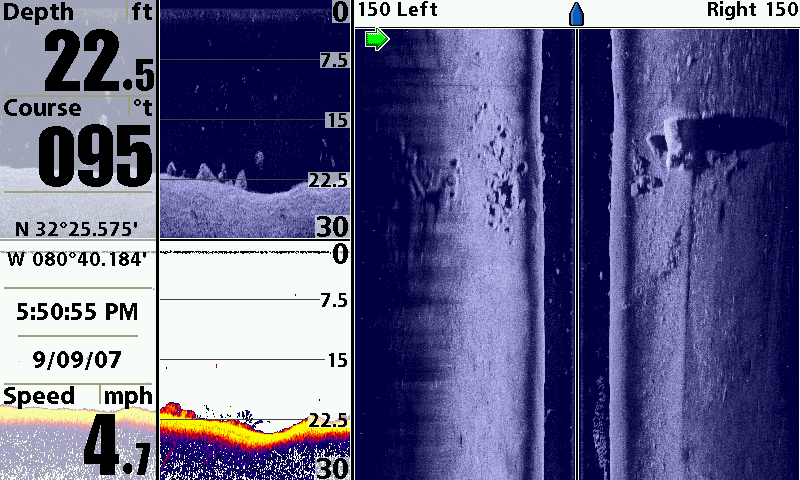

The 1197 puts out the snapshot in .PNG format only.  They originally used the .BMP file format, but later switched to the PNG through a software update.  The BMP files were much larger.
The .DAT file that Chuck is refering to is the data file that stores the waypoint information and a thumbnail of the snapshot.
Here is an image in the original PNG format.
As Chuck mentioned, you can open it in just about any image editor and then save to BMP if needed.
Good Luck,
