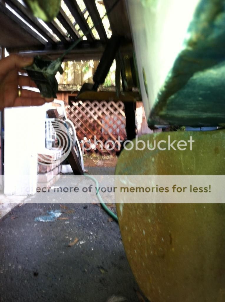

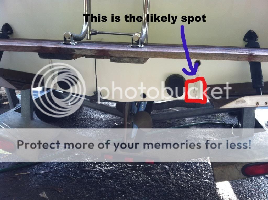

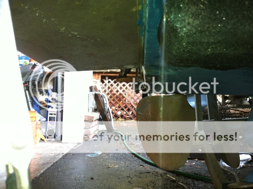

Can you post some pix of your transom ... Both from the rear and each side with the camera at xducer level...??

Ok here are some photos. I'm planning on a 2" block between the transducer and the hull as a standoff so the rudder is out of the way. I'm looking for the best side and place to mount it. I believe I want it on the starboard side opposed prop rotation right?
Thanks for any help.

I don't see anywhere on that transom to mount a SI transducer. The prop wash will get one side and the trim tab the other.

The transducer will be below the trim tabs and I hear if you put it on the opposite side of rotation it will work? Is that bad info? SI will only be needed at 3-4mph basically idle in gear on this boat.
I'm going to try it just looking for advice on the best place to try it.

Because the transducer will be behind the prop, the turbulence will block one side of the transmitted signal regardless of which side you choose.
In this case, I don't think the prop rotation makes any difference.
To clear the trim tab, you would need to mount it lower to get under the tab. Even then, as Rickard has shown, the signal isn't a straight line.
I could be wrong. Wait for more feedback.
