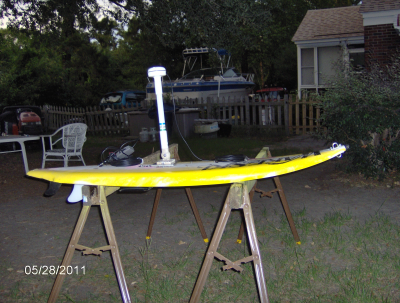

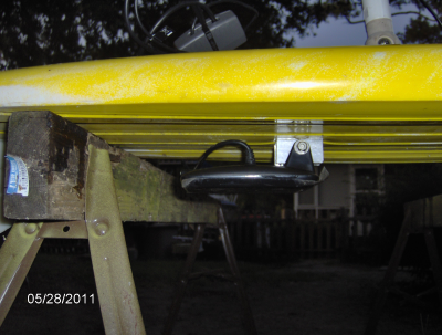

Extreme Shallow Water Side Scan.
Purpose: Larger/deeper draft craft access to shallow water side scan.
Deployment: 1-4 kt boat speed. 3-10' offset boom mountedat 90' to boat C/L.
                    20-150' Xducer cable. 20-150' GPS cable.GPS is at "0" offset .over xducer.
Adj skig fwd and aft.ila_renderedila_rendered :) ;D >:D

Hey Roddy
Good idea!!! :D, but only a solution for shallow water without waves.

Rudiger; Thanks, I was thinking to use Skinny Scan on lakes rivers and swamps.  Thanks Roddy :)
