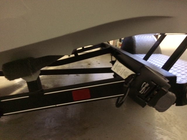

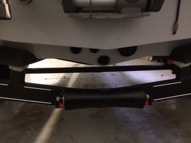

Looking for advice on the best location to mount the XM 9 20 MSI T transducer on a Stratos 186 VLO.
Based on answers to similar posts, I suspect that I'll have to add a Thru Hull XP 9 20 transducer via an MS SI DB Y cable to get depth readings at speed, but need advice on where to mount the SI transducer on the transom.
Also, since the Helix is a CHIRP model, if I do have to add the XP 9 20 Thru Hull, will I have to switch between transducers via the Menu to see depth at speed via the XP 9 20, versus CHIRP etc. from the XM 9 20 MSI T that comes with the Helix?
I've added pics of my transom (I hope!), and any advice would be most welcome.
TIA
FHB

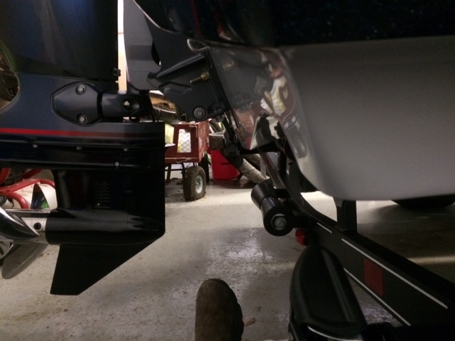

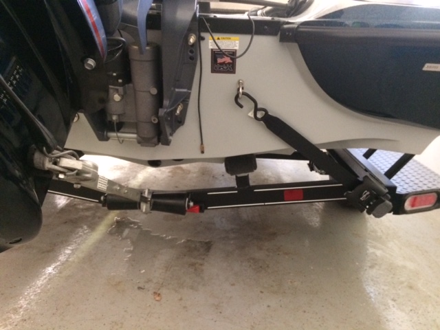

I'm wondering if mounting the XM 9 20 MSI T directly under the motor mount (see 2nd pic) would work.  I believe there is room there without the motor hitting it (see last pic where motor is trimmed all the way in) and that would place it below everything else on the transom while providing it protection.
Assuming it fits lengthwise, would that be a good location?
Correct ... The idea being that the SI beams actually reach all the way to the water's surface ...
Closer to the motor mount will be less likely to block some of the SI beam ...
