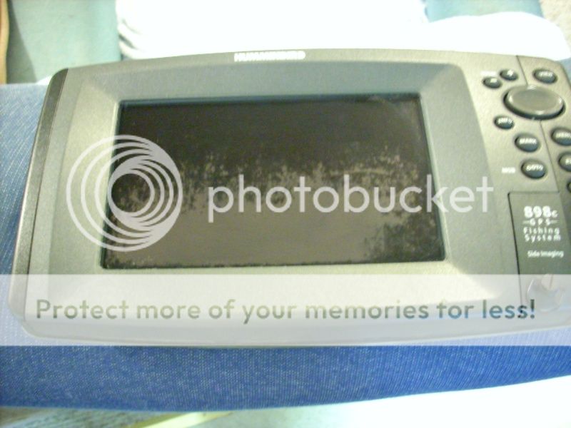

So my 898c is a little over a year old now. I have had no issues with it till now.
Recently the screen has become cloudy. I took a pic and sent it to HB. They say the coating is damaged by me and I need to send it in to be repaired at my expense of over $350.
Even though out of warranty, I feel that I should not be responsible for the damage. I have always used Original Windex with Amonia. I now know they reccomend Windex with vinegar. If the windex I used (probably the most common in the US) woyld damage the screen, then a big flourescent sticker should be put on the screen when new so people know this.
A supervisor is supposed to call me back, but they seem furm on their stance.

It looks like something splashed on your screen that damaged it.  I have read other posts in the past where people have said that insect repellent can damage the screen.
 I don't think there is any known manufacturers defect with the unit that could cause that kind of problem.

Another thing....what type of cloth have you been using ?   The micro cloths is what works best.  Never papertowels or anything harsh.  Also, your never know but you might have had a bad bottle of Windez that had to much Amonia or something like that.  Could be several things.......Good Luck.

I'm with Calli1, maybe your cleaner was defective, or just too strong, or something.
Well, from HB's point of view, like it or not, you probably caused
the damage to the screen, even though you did not do it
on purpose.
On the paperwork with the unit, it does say to read all
instructions thoroughly before using the unit.
I think there are instructions in the manual about how to clean
the screen, and what NOT to use.

Since, from the picture you posted and the fact that's a rare case, I point to user error and not HB fault.

Directly from HB
    Care and Maintenance Information
    Your Humminbird fishfinder is designed to provide years of trouble free operation with virtually no maintenance. Follow these simple procedures to ensure your Humminbird continues to deliver top performance.
    If the unit comes into contact with salt spray simply wipe the affected surfaces with a cloth dampened in fresh water. Do not use a chemical glass cleaner on the lens. Chemicals in the solution may cause cracking in the lens of the unit.
    When cleaning the LCD protective lens, we recommend that your first use a solution of warm mild soapy water (Dawn or similiar mild brand), wipe the face dry and if water spots remain, use a solution of water and vinegar.  Always use a soft cloth. Do not wipe while dirt or grease is on the lens. Be careful to avoid scratching the lens.
    Chemicals like sunscreen and bug spray can cause permenant damage to the protective lens.  This is not covered by warranty.
    If your boat remains in the water for long periods of time, algae and other marine growth can reduce the effectiveness of the transducer. Periodically clean the face of the transducer with liquid detergent. Pivoting the transducer up in the bracket may allow better access for inspection or cleaning.
    If your boat remains out of the water for a long period of time, it may take some time to wet the transducer when returned to the water. Small air bubbles can climb to the surface of the transducer  and interfere with proper operation. These bubbles dissipate with time, or you can wipe the face of  the transducer with your fingers after the transducer is in the water.
    NEVER leave the fishfinder in a closed car or trunk - the extremely high temperatures generated in hot weather can damage the electronics.

Re: Screen coating
« Reply #20 on: May 31, 2012, 07:20:03 PM »
Well, I had seen the screen cleaning subject so many times on forums with the recommendation to use Windex Multisurface with Vinegar, that I assumed it must be in the manual.
I have a .pdf manual for my 1197 as well as a hard copy.  I just searched these manuals and there is no reference to recommended screen cleaning proceedures that I could find.  Also searched an 898 manual....nothing.
This IS a major oversight on Humminbird's part.  The recommended cleaning proceedure should definitely be part of the operator manual!!
Re: Screen coating
« Reply #21 on: May 31, 2012, 07:53:25 PM »
I agree with you Bob, but getting HB to spend money on book is not going well with them.
That is why I like George's suggestion and I am working towards that.
to add to that. This forum is probably the only one that is capable in doing just as he asks since it is a dedicated HB forum operated by independent moderators.
I have seen more issues identified and fixed here than anywhere else.
This forum also has some of the finest guys who willing take time to help with their knowledge and experience.
Most questions are answered by good folks with knowledge. These folks are users of HB and not employees. There is no pay in this for anyone.
We have in effect hijacked the original thread but overall the posting here tie into each other. And are related to the starting topic.

Re: Screen coating
« Reply #22 on: June 01, 2012, 01:30:34 AM »
Thanks everyone for the input. Sorry if I am a little upset about this.
I still feel that HB should have and still could put a sticker on the screen that the user must remove that warns about using the incorrect cleaning solution that may damage the screen. Would not even cost them a penny.
Hopefully others may learn from my error.
For $16 a will try a screen saver and see if it may make it better. Are the screen protectors removable so I can reuse it if I do need a new screen?
...Bill

Well as a last effort, I bought a screen protector. I got the NavProtector. They reccomended putting it on dry but that didnt work so well. So I wet it down and squeegie with a CC. Went on great and screen looks like new. No signs of the missing/blotched coating. Hopefully it will work out.
...Bill
