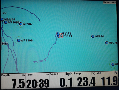

Yesterday we were on water with my client and tried to tuning some equipment - were 1198cx and attached the new AS GPS HS.
Firmware – 6.640. We were anchored position, no windy, waves or other weather influences  and we saw a strange anomaly.
See the picture 1.
The anchored boat started move on the 1198 screen, but our real location was still stable.
As you can see from pict 1 drift was more than 30 meters during a couple of minutes and the speed, during move, was 0,0.
Then I returned the firmware to 6.610 and after around 20 minutes I saw the fantom moved like previous.
This situation have repeated again, 2-3 times per day in different time and places.  With AS GR50 we never saw any problem yet.

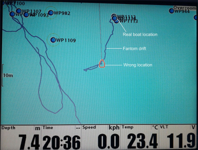

After this anomaly I turned of the 1198 and then turned on. The boat was in real location.
See the picture 2.
What happened?
Is it problem with AS GPS HS or head 1198..?
