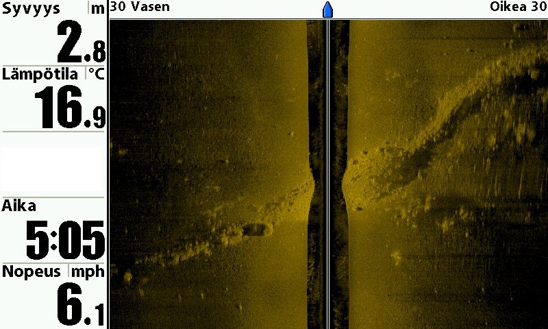

First test drive with my towfish! The cable is actually 33m long. Towfish was 5-7m down from sea level when i scanned. Here are the screenshots. All taken 455khz.
Rocks... wondering why is temperature so high in this screen?

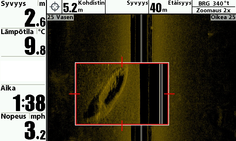

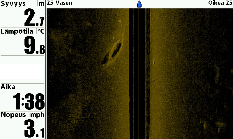

Sunken wood boat. (zoom)
One possibility is that seawater has come in contact whit the temperature sensor? The transducer is not built for highpressure in deepwater.
What happend after this "dive". Did the temp.readings go back to "normal"?
It can also has something to do whit the cable. (leaks, length?)
Greattings from south, terveisin etelästä. Kimi..

Hi neighbor ;)
This forum has already been reported that the cable inlet into the transducer is not pressurewater tight. >:(
Most resins shrink during curing and so the smallest leaks can arise.
mvh
Rüdiger

Towfish has worked just fine and the information on screen is correct.
