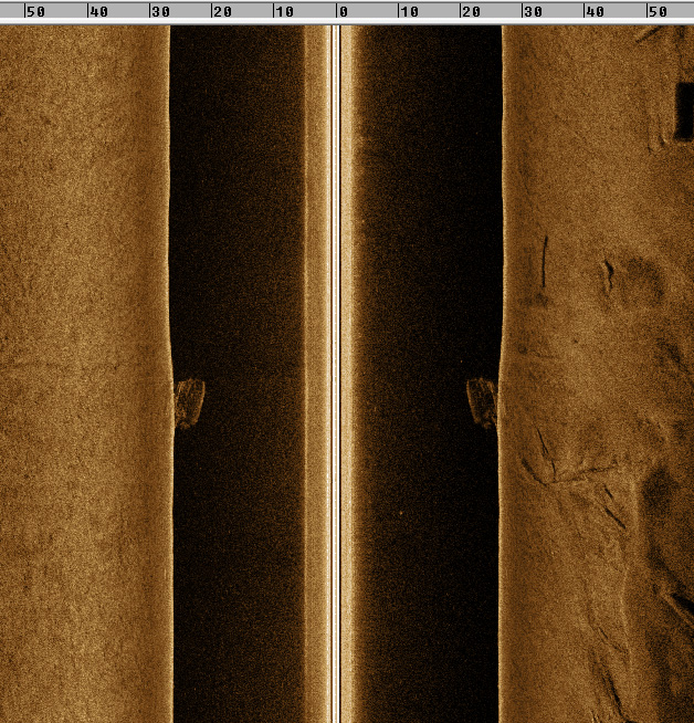

George,
Yes, with SI in 455khz you are getting almost 180deg of coverage, even right below the boat.  800khz does have a gap though.  They did not have to modify the transducer because the data is already there!  Its just presented in a different way.
Here is a scan of a small 14' boat sitting on its side in 30' of water at 455khz.  Notice how the boat appears on both sides symetrically.  The only way this would happen is if I had passed directly over it.

« Reply #7 on: January 29, 2010, 06:33:28 PM »
Robert,
Thanks now that I looked at your picture, I have observed these on my own system.

« Reply #8 on: January 29, 2010, 06:47:29 PM »
This was done in photoshop and basically turned the image I exported from the playback on the PC on its side.  I will post the actual DI image later tonight for comparison when I get a chance. Hmmmmm!
I need to go take my 997 out of the boat and play it back.
UPDATED: Here is the actual Down Imaging snapshot from the 997c.  I would have to say that its pretty obvious that its just an average of the two sides from the SI data. We know nothing new is being recorded since we can play back older files.  I still prefer the SI views. Its the same data, just turned sideways! And really does not have the detail that the SI view offers or ability to determine the position of the object left or right of the boat.  Its a neat feature though!  Just my two cents!
