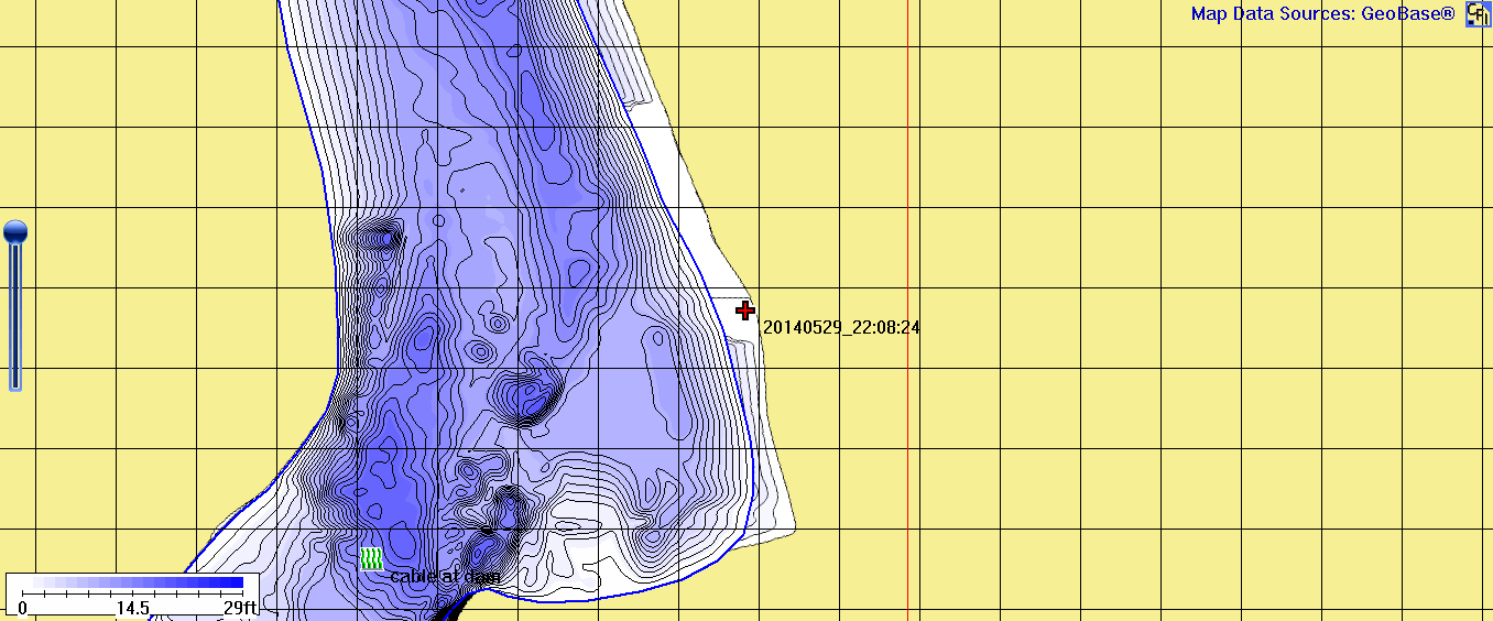

new problems......
i created a map with autocharts shorelines...(not very accurate) and updated my sd zerolines card...
then decided to draw my own improved shore line in google earth and import
then created map with my new improved  shorelines and updated zerolines sd card
but the zerolones sd card map includes an ovelap of the old data i dont want!
does anyone know how to edit the sd zerolines card map??
 it seems i can edit the map on the pc but not the sd card data??
ila_rendered suggestions?? see attached image i put a waypoint on the incorrect data i wish to edit
stgr

update on editing zerolines data on card ....
i called HB support was told that once data is written to card it cant be changed ,
so they advised me to delete the AC file  on the zerolines card and start over with new map ...
so i re created a new map  with my own shorelines(way more accurate then zerolines data!)  ...it created a new AC file on card  ,and all is good now
ps other option is to work off local copy of map on PC before exporting to zerolines card so you dont have to start all over
P.S .HB support is limited ...you may have to ask for a supervisor !
ds

trytoofish,,
sorry i should have been more clear...
u can add data to the card and update as you go ....but what i was trying to do was delete/erase data outside of the shoreline that had already been written to card  .
see prevous post i put a waypoint on problem area i was trying to get rid of
 the blue outline is my own handdrawn shoreline  (zerolines  default shorelines not very accurate in CANADA they must have used mapquest  or other rather then GE to draw zerolines shoreline )
ds
