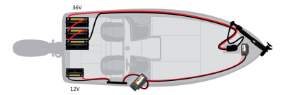

"Are the boat systems and trolling motor on separate batteries?"
This is the first question I always ask. Always. As far as an electronic device goes, electric motors are horribly noisy, and that noise travels all along the conductors of the trolling motor system. Connect your fish finder to it, and you’re guaranteed to have noise---not necessarily when the motor is off, but whenever it is on, you will have noise.
You should put your sonar fish finder on the same system as your cranking battery and boat systems (lights, live wells, etc…). The basic layout should be like this (click image to enlarge):
If you are guilty of having both on one system, the obvious solution is to add a battery and separate the two systems. Electrical isolation of the two systems is essential. BUT you don’t necessarily have to have a $150, 60 lb deep cycle marine battery for your sonar. If your sonar has a 5” or smaller screen, try a canister-type, gel cell, or motorcycle battery. Twelve volts is twelve volts---it doesn’t really matter what form it comes in. Smaller units draw less current and you can often get through a fishing day on a smaller battery.

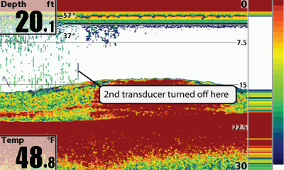

Another potential solution for two interfering transducers….just deal with it. The noise filtering algorithms of modern are so good, that interfering sonar units rarely result in significant deterioration of digital depth, bottom prints, or other targets. Most of the time you get streaking lines that appear like rain, but you won't loose targets. The interference may be annoying, but 99% of the time it doesn’t affect the ability of the sonar to resolve and display targets.

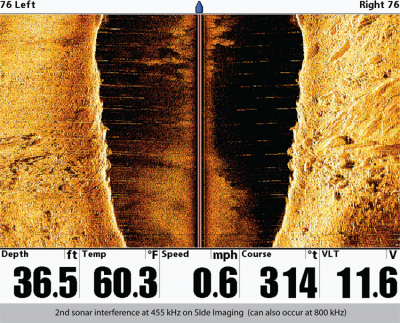

Below is an example of sonar display where the interfering transducer has been turned off. The interference is the vertical dashed lines on the left.  To the right, the display is clear (after the other unit was turned off).
NOTE: (before I get hate mail on this picture) Although it would appear that the brush pile sitting in 20ft shows a stronger return after the 2nd transducer is turned off, as indicated by the stronger red return, it actually shows the boat being more positioned over the pile rather than on the fringe of it—the boat was drifting slowly over the pile. You normally won’t see much difference in the strength of sonar returns when exposed to interference and not exposed to interference. However, this is not always the case and some (rare) installations may be completely blanketed by a 2nd transducer.
It Happens A LOT
Sonar interference can occur at any frequency and any type of display. The tell-tale signs of 2nd sonar interference can be clearly seen as similar dashed lines in this Side Imaging view at 455 kHz:
NOTE: trolling motor noise may appear similar, but will come and go as you engage and disengage the motor.

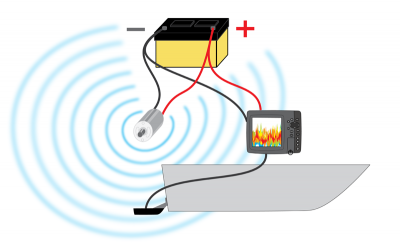

In general, most guys know the basics of how to set up a fishing boat: keep the trolling motor and sonar systems separated, keep the transducer wet and clear of obstructions, use of 2nd transducers will interfere so turn one off or change frequencies, etc, etc…. But when we follow the rules and still get problems, it leaves us scratching our heads.
I Still Don't Get It

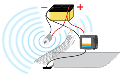

Here’s the voodoo that is going on: You can think of any wire carrying current as a broadcasting radio antenna, and your sonar system as the unfortunate receiver. The higher the current in the wire, the “louder” the broadcast.  Engineers refer to this broadcast as radio frequency (RF) noise, because the offending waves are typically in the radio range of electro-magnetic radiation.  The goal is to block and/or suppress the reception of RF noise wherever possible.

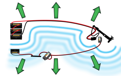

1. Physically locate EACH COMPONENT of the sonar system as far away from offending sources (eh-hem…trolling motor) as possible, and
2. Shield and ground any entry points.
A common mistake that many anglers make is to zip-tie a transducer cable to the steering cables of the trolling motor. The steering cable bundle includes the power cables going to the electric motor in the lower unit. When you tie the transducer cable to the steering cable bundle, you’re aligning the transducer cable to the trolling motor power cables.  Naturally, your ultra-sensitive sonar picks up trolling motor noise here and you subsequently have noise problems.
Try to keep the two apart as much as possible.
When routing your transducer cable, meet the trolling motor frame at the point where the trolling motor pivots, then secure the cable to the trolling motor the remaining way down the shaft. Don't worry about all the wires being aligned down the shaft --Routing the transducer cable down the trolling motor shaft is a necessity, and typically not a problem because the power cables are inside the conductive shaft. And be sure to see our tip on grounding trolling motor noise later in this article.
And keep the two systems apart.
Did I mention that?
  ...seriously.
Keep them apart.

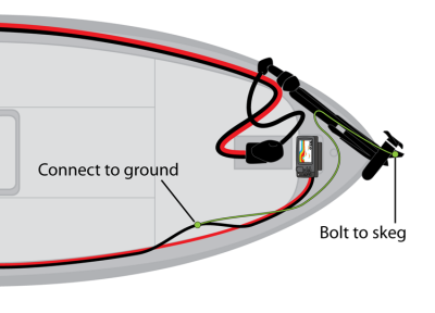

The #1 Trolling Motor Noise Fix
If you have a particularly noisy component (eh hem…trolling motor) and suspect it is the culprit of noise problems, you can capture the noise near the source and dump it in the same manner described previously. Normaly, we try to capture noise near the victim component then dump the noise, but this works too...
Try grounding the trolling motor frame to the negative side of your sonar battery. The recommended method is to drill a hole in your trolling motor skeg, put a bolt through it, and connect a grounding wire. Then tidy up the installation with zip ties.
How that works...
Conceptually, the frame of the trolling motor is conductive and “shrouds” the noisy motor inside. All you have to do is ground the frame to the sonar’s battery.

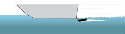

Physical Signal Disruption is just what it sounds like: disruption of the sonar sound wave below the transducer. You get this type of interference with transom-mounted or in-hull-mounted transducer and only when the boat is moving forward.

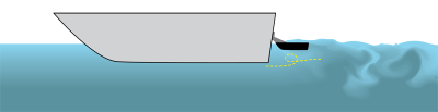

The disruption can be disturbed (swirling) water, bubbles, or an actual air gap. The first of these, disturbed water, can be the most puzzling to diagnose, because your transducer is fully wet, and the apparent “noise” comes and goes with small changes in boat speed. The setup looks like this:

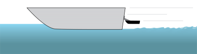

Water slides along the bottom of the boat hull, then spills over the rear edge of the transom. The swirling water is detected by the super-sensitive transducer and may appear as clouds of haze on your display.
Under certain conditions, this swirling of water can cause serious performance issues for your sonar (see Compounding Complications later in this article).

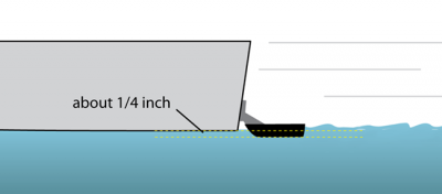

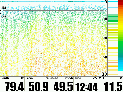

At higher speeds, as water shears off the back of the boat, your transducer may become completely out of the water if it is mounted above the lowest part of the hull. The sonar signal cannot penetrate the air, and so you will lose sonar signal. The header image of this article (on the first page) is an example of what your sonar looks like when this happens---complete black-out. Below is an illustration of this case:
If you want high-speed depth, you need to mount your transducer lower than the bottom of the boat. Typically, about 1/4” is sufficiently low, but if the bottom of your hull is not smooth (has rivets, lateral steps, etc..) then you may need to go lower.
The risk of going lower than the hull is that you put the transducer at more risk for striking a floating object, such as a piece of wood or floating vegetation. Small objects floating in the water, struck at high speed, can put tremendous load on the transducer. So much so that they can complete rip the transducer from the hull. So you want to be just deep enough to get a good reading and no more.
Be aware also that your transducer should be level or slightly tilted forward when running ---not necessarily whatever angle it is at on your trailer. If the transducer is tilted backwards, you will get cavitation under the transducer and loose sonar signal, as illustrated here:

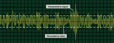

It may be of interest to you to know what it is exactly that you’re fighting. In signal processing, the concept of signal-to-noise ratio is an important characterization of the information handled by the sonar circuitry. Your sonar sends a sound wave into the water, and coming back is a random, jumbled mess of strong and weak pulses. Which of these pulses are sonar targets? Which are noise?  The theories and practices that are used to make sense of it all have their roots in radar signal processing and were largely developed during World War II and fundamentally haven’t changed since.
However, the actual signal processing algorithms that make sense of the return signal are exceptionally complicated, constantly evolving, and proprietary---so we couldn’t tell you what they were even if we knew. However, the common principle among most of them is that signal strength over a threshold is interpreted as “signal” and below the threshold as “noise”. This concept is illustrated below (data is simulated):
The signal processing software in your control head will process both “noise” in the returning pulse signal and “noise” picked up in your boat’s electrical system. What is left over is the signal, and is what ends up being shown on your display. You can watch real-time signals by turning on real-time-sonar (RTS) on in your settings menu.
Sometimes the true signal is below the threshold, and sometimes the true noise is above the threshold---causing errors in both cases. The task of robust interpretation is non-trivial, and when you dig into the details of signal processing, it’s a wonder we are ever able to paint a fish on the graph at all!
