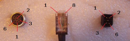

The round ethernet connector (called 'M12/8') Humminbird uses is also used in 'industrial' Ethernet applications so it is possible to get ready made cables from electronics suppliers. However, it is easy to make your own cable. If you have a 798HD unit get a Humminbird Ethernet adapter cable or accessory bus cable. If you have a unit with the round connector, get Humminbird Ethernet cable. Cut off one end, strip the wires and connect a standard RJ45 plug this way:
All numbers refer to the RJ45 (i.e. you will only use 1,2,3,6 on the RJ45). You do not need to connect the shield wire.
You can either press a RJ45 plug directly to the cable if you got the tools for it, or simply cut off a standard Ethernet cable and connect bare wires. If you do the later, make sure not to untwist the wires more than necessary, they are twisted for a reason.

It is not a great job to build the cable self.
You need a original HB-ethernetcable, a plug and a presstool. Then cut the cable in two parts,  prof witch wire you need after that you must press the plug  on these end.
I think, a good computershop can do this all for you.
