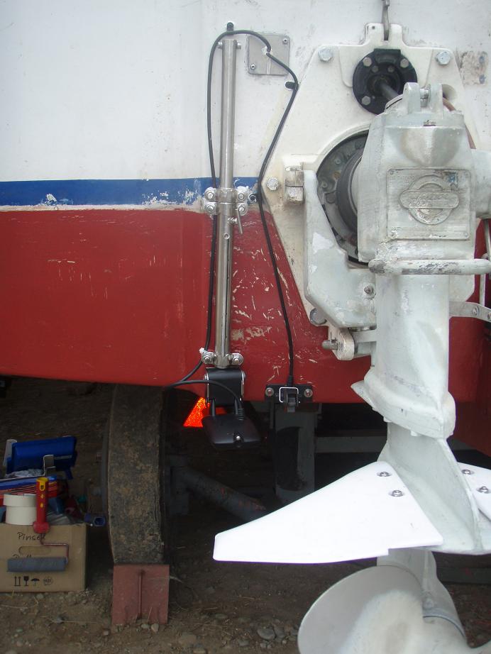

Hello Babarosa,
have you ever thought about a telescopic mount?
I had my transducer mounted like that two years ago and it worked very well. Here's something I wrote about it and Hendrik dropped in with some good ideas as well:
http://forums.sideimagingsoft.com/index.php?topic=158.0
This might work for your boat and surroundings too.
After I had the under water part of my hull renovated (and cut off the stabilizer) last winter, I have the transducer mounted now without the telescope. If you need it, it's still somewhere in my shop here and I would send it to you if neccessary.
Good luck and best wishes / Harry

My thoughts exactly Harry.  Perfect scenario for this application.
You are just not going to get decent if any side imaging from mounting it in the hull, especially a wood hull.  If it was fiberglass, you may be able to get some decent results, but its hard to get the right position so you get good left and right SI.  The transducer has to be level since the SI elements are on the side of the transdcuer at an angle.
I would certainly look at some of the images in the gallery.  There are several guys here who have built telescoping mounts.

I had the same problem whit my boat as babarosa have. No good place to put the transducer. So the only place to put it was in the front. It as also be fixed so it is easy to take of when risk to hit a rock is big.
So I made a temporary aluminium pipe in the front of the boat. Se my pics
This temporary thing has now been used  for over 2years and 120 h. And still working!
