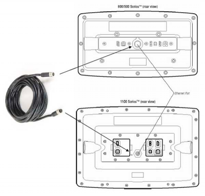

800/900/1100 Series Ethernet
To get Ethernet on a 800,900 or 1100 series units all you have to do is plug an Ethernet cable into the metal connectors on the back of each unit as shown. The following 800,900 and 1100 series units are compatible with Ethernet: 858c, 898c SI, 958c, 998c SI, 1197c SI, 1198c SI
Ethernet cables are available in 4 lengths:
 2 foot- AS EC 2E
10 foot- AS EC 10E
20 foot- AS EC 20 E
30 foot- AS EC 30 E
There is also a 30 foot  extension cable if more length is required:
AS ECX 30 E
Also make sure both units have the correct software for Ethernet functionality

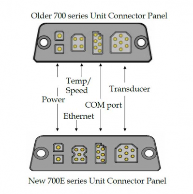

700 HD Series Ethernet
To Ethernet a 700 HD Series unit you will need to add an adapter on to the end of the standard Ethernet cables mentioned on the previous page. This cable is the AS EC QDE. It is shown below:
The 700 HD Series units that are compatible with Ethernet are 798ci SI HD, 788ci, 778c HD and 788ci HD DI. No other 700 series units are compatible with Ethernet.

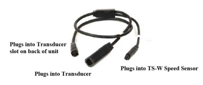

If you ever have a situation where a consumer wants to use a TS-W Speed Sensor (paddle wheel) or a separate Temp Sensor (TG-W) with a 700 HD Series unit that is connected via Ethernet you will have to use an adapter since the Temp/Speed plug on the back of the 700 HD Series unit has been replaced by the Ethernet connector. This adapter is AS SW Y and is shown below. I don’t think you will see this requirement very often.
