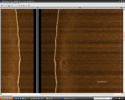

2 days scaning in salt wather over  30 m, towfish with 60 m cable
i thing that scaning in salt water is possible in 455 khz but difficult in 800 because in 800 a little wave or interference make a very bad picture, problem with current to take the target in 8 or 10 meter range
i join sampleila_rendered in 455 khz, good picture
[ Specified attachment is not available ]
in 800 khz there's more noise (wave, motor...) the picture is not good
800 khz is very nice in river
i hope that a double ducer in 455 khz is a good solution in salt water...

picture in 455ila_rendered
