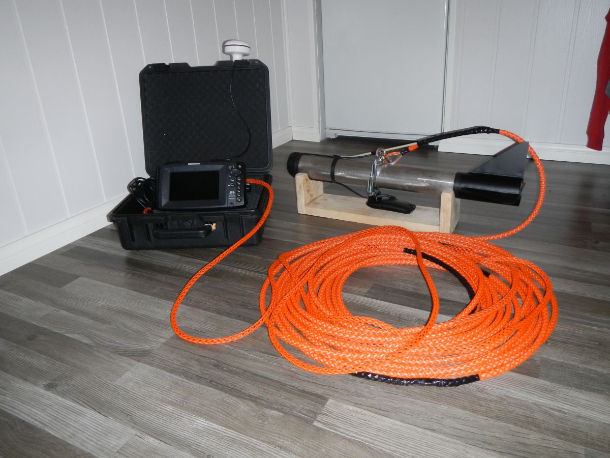

Towfish Prototype #1 Latvian

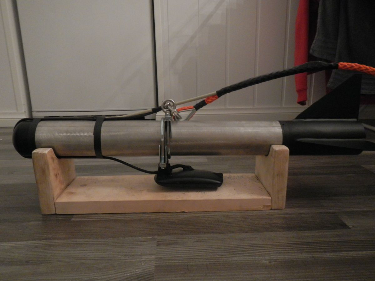

First test results are very good! :)
Tube length 110cm
Wings- 2mm Plastic
Tube diameter 50mm (Metal 1.5mm tick)
Weight > 10kg
Towfish metal nose 20cm/10+10cm (inside)
Original extension cables
Humminbird Transom Transducer XHS 9 HDSI 180 T 710201-1

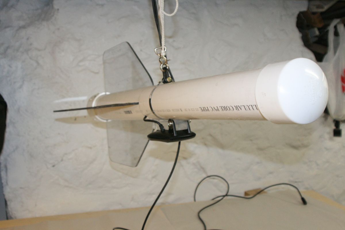

My second towfish.
This one is built from a plastic wastewaterpipe. Nosecone is aluminium, and filled with lead. Th tranceducer is a thruhull model. Fins are made of polycarbonate.

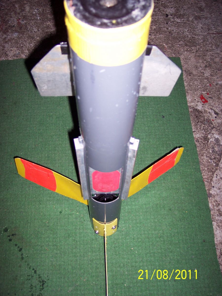

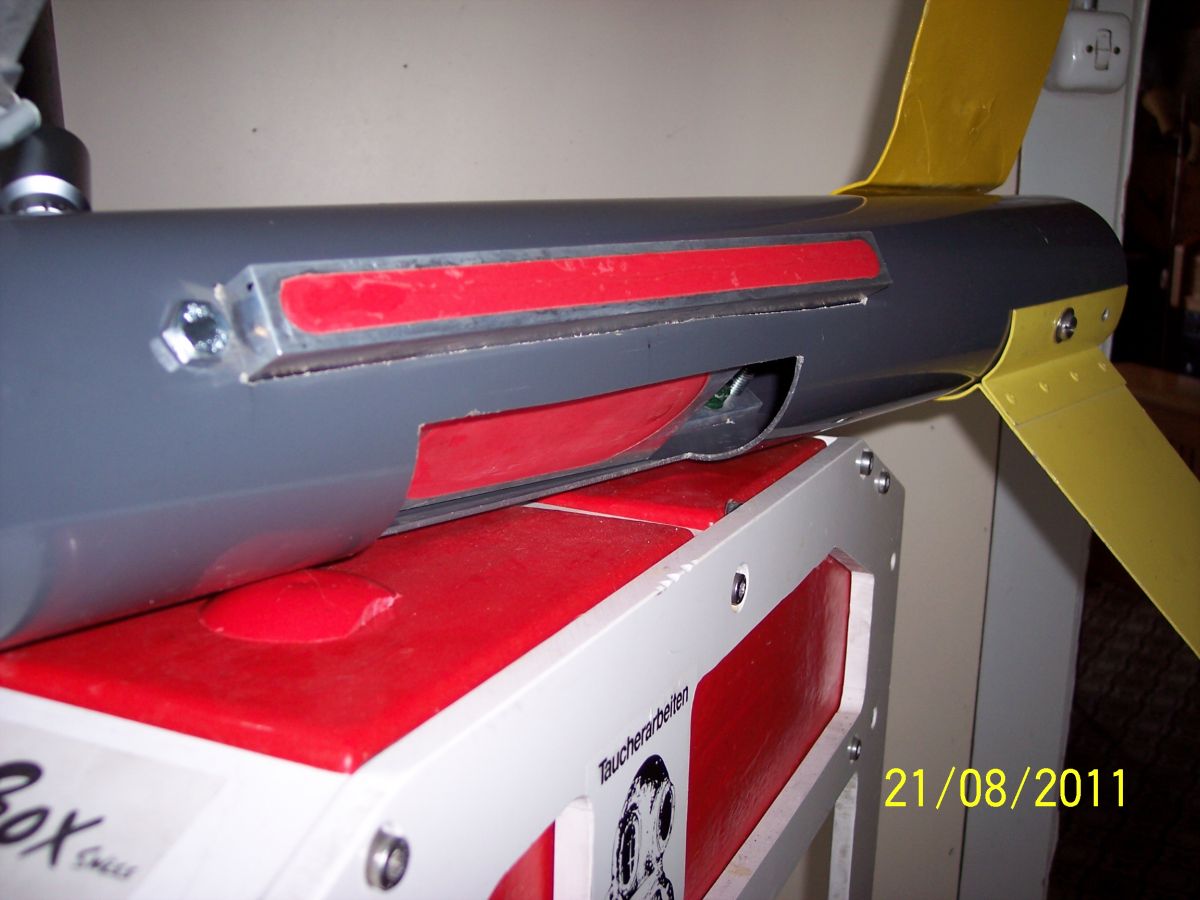

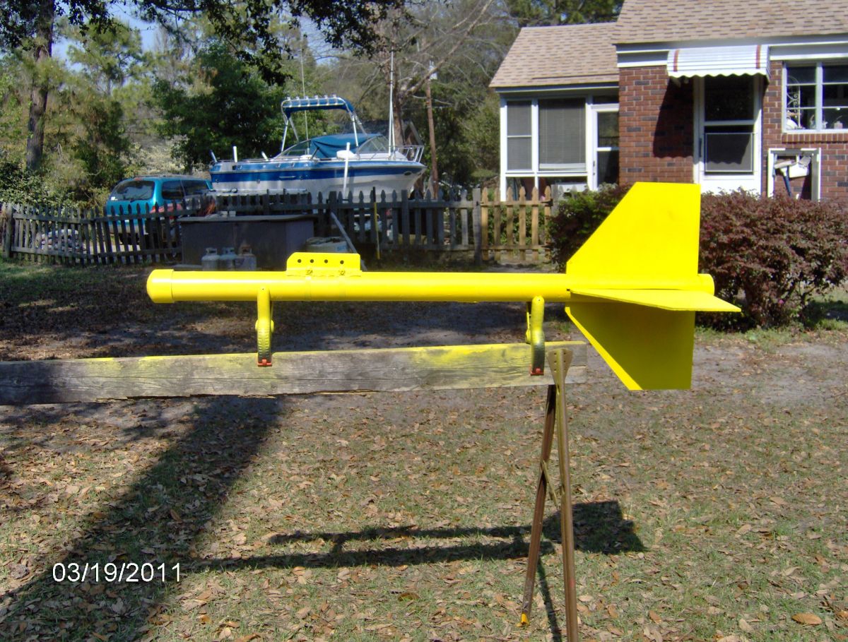

IMG 2872
Made this out of PVC.  Plex fins.   I cut the body for the fins to be disassembled.  I balance the fish with lead on each end.  If anyone wants more info I will have to look at old notes.

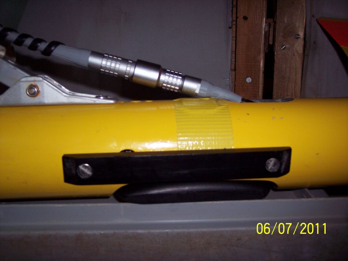

HPIM0987
TF3 xducer mount

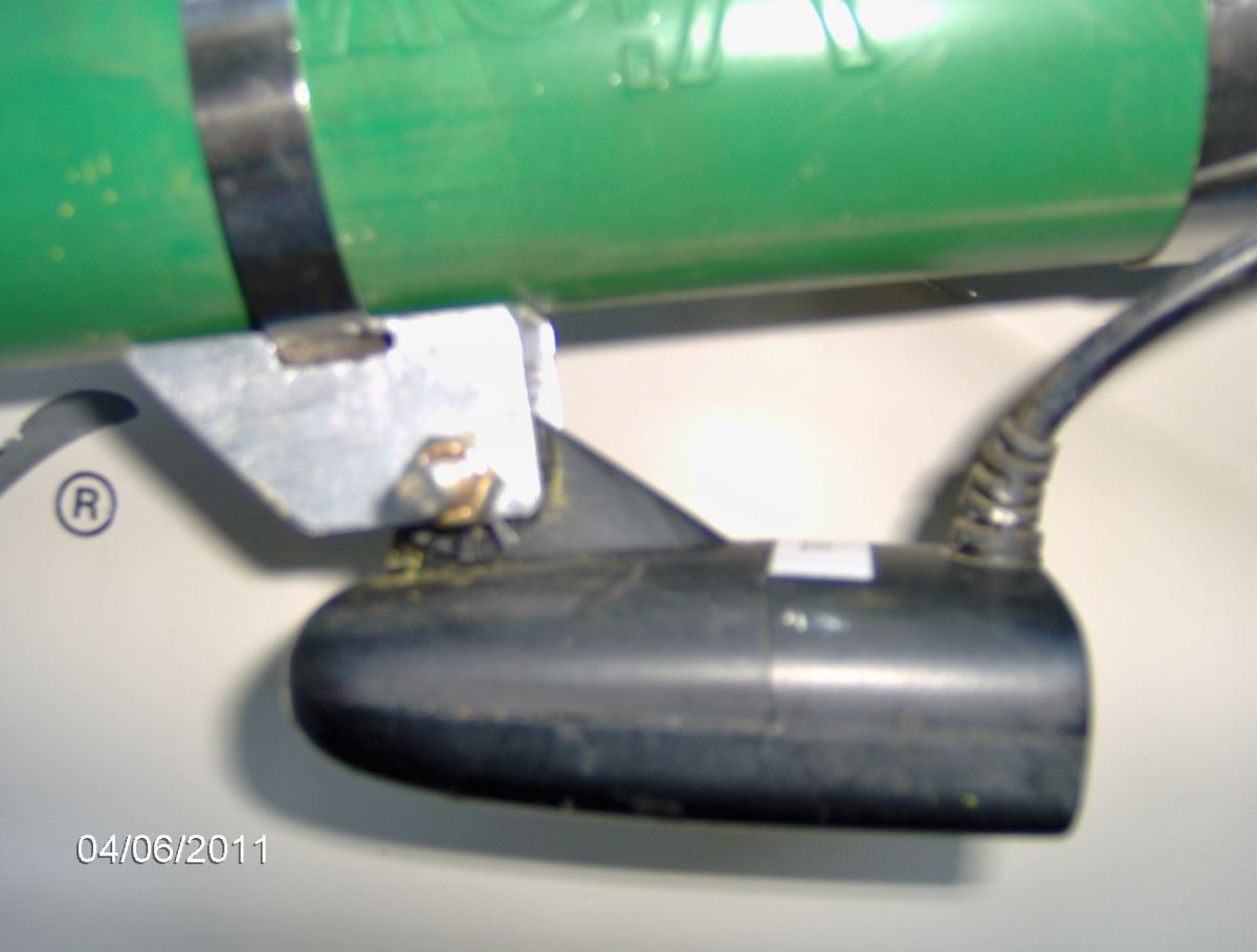

HPIM0985

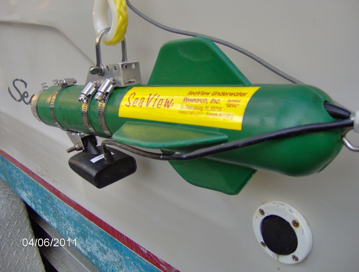

Tow Fish #3

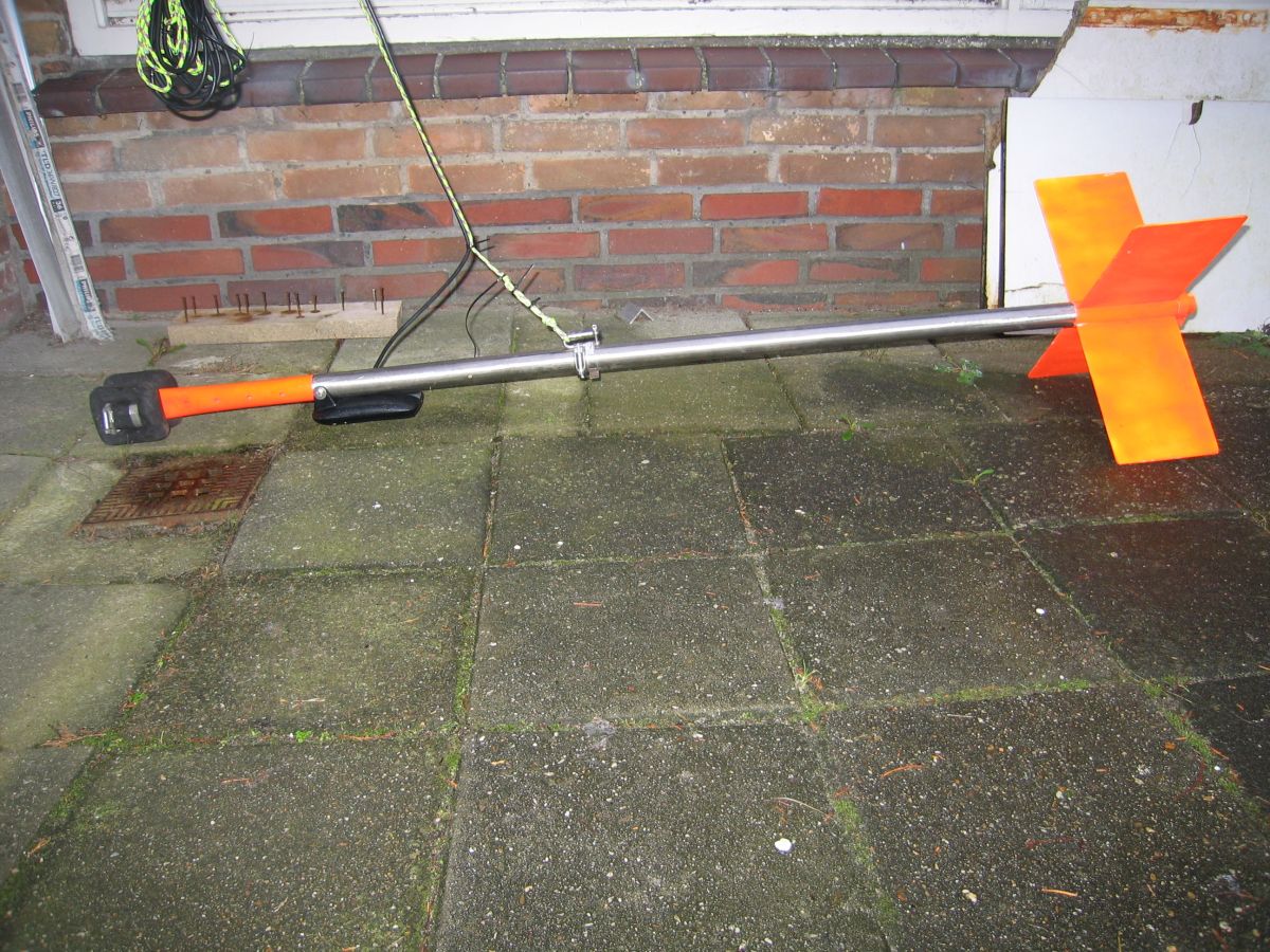

Terschelling's towfish
Some figures:
Lenght  1.50m
Tail fin in X configuration , made out of 2mm stainless steel plate  14 x 45 cm
Pipe 32mm diam. wallthickness 1mm,  transducer simply connected with bolt & nut.
2 divebelt weights of 2kg at the front.
towing point: shackle which is connected tothe pipe by stainless steel…
