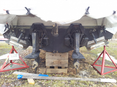

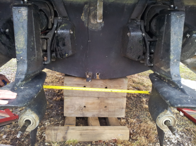

I have a 9.5 foot width, with twin inboard/outboards.   When I first purchased it, i was assuming I'd just mount it in the center of the transom.  After reviewing some posts on here and online, I am now wondering if the outdrives will cause interference.
There is a 32 inch span between the outdrives, therefore if I mounted close to center (due to drain plug), I'd have about 13 inches on one side and 19 on the other.  The outdrives are approximately 4 inches off the transom.
So my first question would be is that acceptable clearance and would a transom mount be acceptable?

Pictures of the transom are attached.

With only four inches of clearance between the transom and the outdrives of your I/O’s, you will be blocking the left and right Si sonar if you center mount it on the transom.  The standard transducer that comes with the 898 units needs seven inches of clearance between the transom and outdrives to ensure no blockage.  Installing two Si transducers on the transom (outside of the outdrives) may not work either due to the trim tabs – but I really can’t say that for sure as I can’t see how far down on the transom they really are nor how far down you have to run them.  That may be an option though.  You will need the AS-Si-LR-Y cable for this.  Personally I would try mounting only one transducer and see if you get any blockage before spending the money on two and the Y cable and finding out the Si sonar is still blocked.
For a Thru-Hull transducer I think that you would have to mount it under the keel for best results.  You don’t have to use the included fairing block on the outside of the hull so you will only have the transducer sticking out 1.3 inches at the most (it actually tapers from the front to the rear).  I’m sure that this would produce some drag on the boat itself and you would have to watch when trailering or when hauling it out of the water so it does not get damaged.
