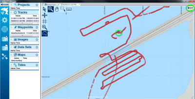

The first thing I notice about your track log is that it doesn't appear to have any depth information. The colours of the track points vary with the depth from red, the shallowest, to blue for the deepest. On close inspection it is possible that you have depth but that you have some extremely deep track points (circled) that are expanding the depth range to such an extent that all of the other track points are very shallow by comparison, and show in the red colour.

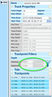

Let's make sure we have some depth data before we make the map. Open the EDIT pane by clicking the Edit bottom at the top right of the screen. You'll see  something like the image above - note that you may need to expand the track points and properties panes by clicking on the headers.
Try filtering the deep track points out by moving the bottom slider in the Depth Filters section to the left. The track points that are filtered will go grey. Once all of the existing blue track points have gone grey, click the Filter button (the funnel). This will remove the offending track points and recalibrate the colors.
If the track now looks less uniformly red, with a good range of colors, that indicates some good depth data. You can also take a look at the track points in the list at the bottom of the Edit pane and look at the depth values there.

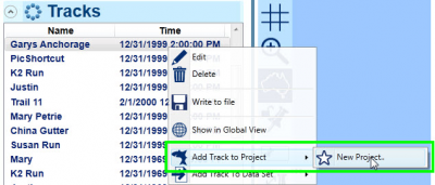

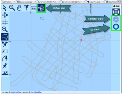

To see the 3D data, you need to make a new map project and add the track. You can do this in one operation by right clicking the track either in the asset library or the global view, and selecting the Add Track To Project->New Project option. That will create a new project and put you on the "define map area" screen. This is where you draw the outline of the area you want to map in 3D. Select the Define Map mouse tool and draw a rectangle over the area of interest - start by using your whole track area and see how you go. The map will generate and you will see the gridded depths. Then click on either the contour or 3D view buttons on the right (arrowed) and you should be good to go.

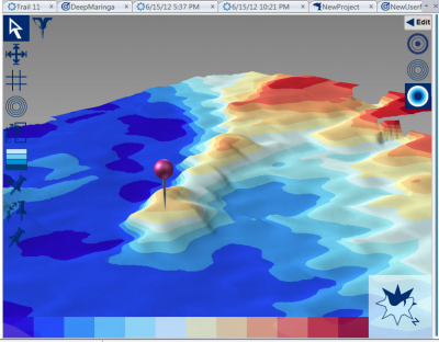

Here's final result of the track I used in the example above - a sand spit that juts out from a sandbank here in Hervey Bay, Australia. Quite shallow, but it often holds a few fish along the edges!
