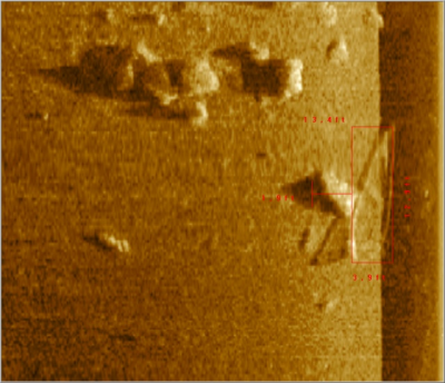

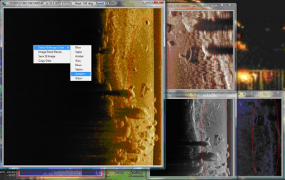

New features HumFinder v.2.0
- Display user selectable SI images of target area
     - Aspect ratio correction is used (vertical dimensions correlates with horizontal ones, with certain limitations)
     - Independently zoomable SI images
     - SI Images are pannable when zoomed
     - Image windows are resizeable
     - SI image color is user selectable
     - Measuring tool for measuring dimensions, object height estimation
     - Image copying, saving possibilities
- Search radius extended to 100 000 feet (30 000km). With 3000ft (1000m) and above only SI tracks are shown
- Abort button added to cancel search on time consuming operations
- Automatic comma separated position (Lat, Lon) tracking from clipboard. Can be used for example with HumViewer

Some screenshots from HumFinder new features:
