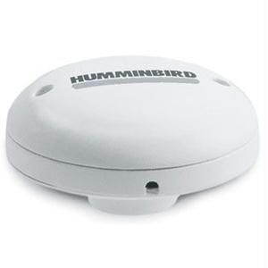

Hey guys, great forum. Just got a used unit and it needs a new receiver. There seems to be 2 versions of the same part number receiver. In the pictures one seems to have a tab on the bottom and the other one looks to have a flat bottom. Anyone know what the difference is?
Re: GPS antenna(receiver)
« Reply #1 on: June 24, 2012, 10:52:05 AM »
The GPS receiver "with" the tab is the AS GR16 channel...
The GPS receiver "without" the tab is the AS GR50 channel...
Check your unit's compatability here...
http://store.humminbird.com/category/269117/GPS_Receivers

Thanks for the reply. I think the on-line store I was looking at has the wrong pic. but the correct description.(I hope)

What model Humminbird unit do you have that needs a GPS Receiver?  Not all are compatible with all model units.
That is not even a correct picture of the GR16 GPS Receiver on the Humminbird web site.  The GR16 GPS Receiver uses the same housings and gasket between them as does the GR50 GPS Receiver.  Plus on the GR50 GPS Receiver picture they used the discontinued AS-GRHA GPS Receiver!   ::)  I’ve asked that these pictures be updated but they so far have not been.

It is a 997si. AS GR50 should be here tomorrow and then we'll see if the picture is wrong.
« Reply #6 on: June 27, 2012, 02:40:21 PM »
The picture will not be right.  The AS-GR50 has “AS-GR50 GPS MODULE” printed on the top of it.  The GR50 will work with your 997c Si unit.

Thanks for  all the help. It came in yesterday,AS GR50.  Plugged it up and it's amazing how good my unit works with a functional receiver. Thanks again for all the help.
