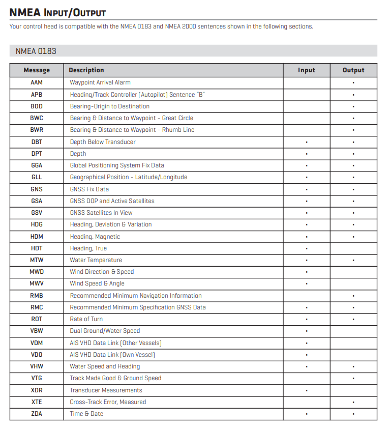

« Last post by Kenai on May 02, 2026, 10:08:51 AM »Update: I found this in Humminbird ION 10 — comprehensive Installation Guide for Control Head and Accessories

Accessories / Re: AS GPS nmea sentences« Last post by Kenai on May 02, 2026, 10:08:51 AM »Update: I found this in Humminbird ION 10 — comprehensive Installation Guide for Control Head and Accessories

Accessories / Re: AS GPS nmea sentences« Last post by Kenai on May 02, 2026, 09:51:34 AM »Well similar project here. Any update from anybody ?
I'm tiring to setup Holybro M9N GPS to use with Helix. It is 6 time cheaper and many time more precise and modern unit than original HB puck AS GPS HS. 13
