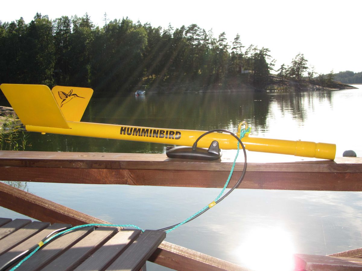

This is my first towfish project. Anyone can build one like this in a few hours. Its all made in aluminum.
A led weight 2,5 kg, is in the front. I have only tested it whit standard cabellenght. It seem to work well.
I  made it whit a V-tail, because its easier to build, and it will not get stuck in the seabottom as easy as a fourblade tail. At least I hope so?
I gave it the name "Vesihiisi" (Seatrull), after the famous Finnish ww2 submarine. A seatrull was also a fictive creature we use to scare the kids whit, so they would stay away from shoreline and not get drowned.
